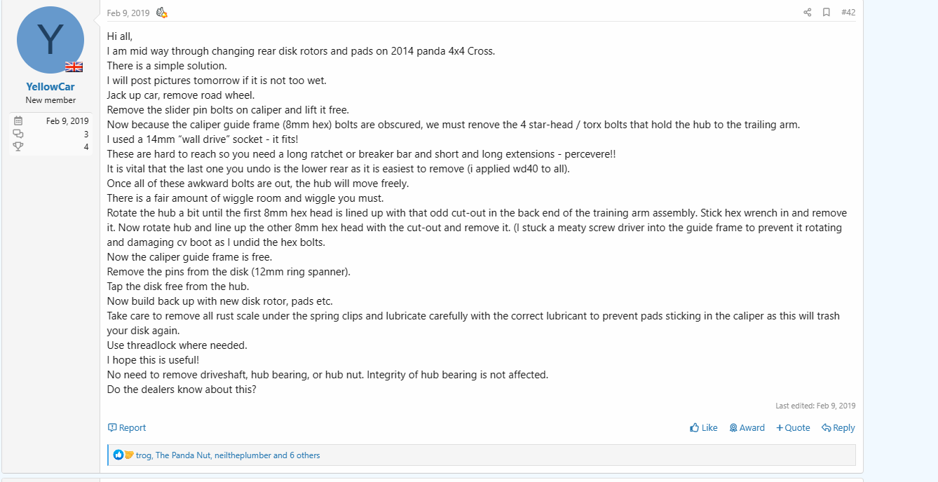

You don't have to remove the hub bolts (this is a myth that gets regurgitated regularly on here)! It is one way to do it and some professional workshops take this route to save time; do look for @yellow car's post on here. Why risk screwing up the wheel bearings?

Cool I was going to undo the 4 bolts around the hub bearing holder to rotate the hub to get to the caliper carrier allen keys, I'm a great believer in fabricating my own tools, tightarse possibly but I call it practical🤣🤣

You are right - typed too quickly. This Yellowcar, this thread https://www.fiatforum.com/threads/4x4-rear-brake-discs.437398/page-3

I'm going to try my method 1st I'm pretty good with mechanics as I work on garden machinery for a living, some of the axles I work with on ride ons are full gear mechs, so this to me is simple I cracked the tight threads on the left rear hub lunchtime so they will come out nice and easy and Monday lunchtime I will crack off the right rear hub bolts, so there ready for Thursdays work if worst comes to worst I will pull the drive shafts and press in new bearings if they get knackered, thanks for the bearing tip I intent to keep this great car on the road till I retire 10+ years down the line

I’m interested in seeing how you get on, im sure I added some tips/findings to Yellowcars thread at the time as I did it by attacking it from the rear. I reckon I do discs n pads in an hour and half a side now I know the knack, if that gives you an idea on time verses risk.

When I do them I will take photos of everything I do I might try one side the yellowcar way and the other side by removing the hub, and see if I can get the wheel hub off without knacking the wheel bearing, what annoys me is if fiat had used their noodle they wouldn't have hidden the caliper carriers bolt behind the bloody subframe!
