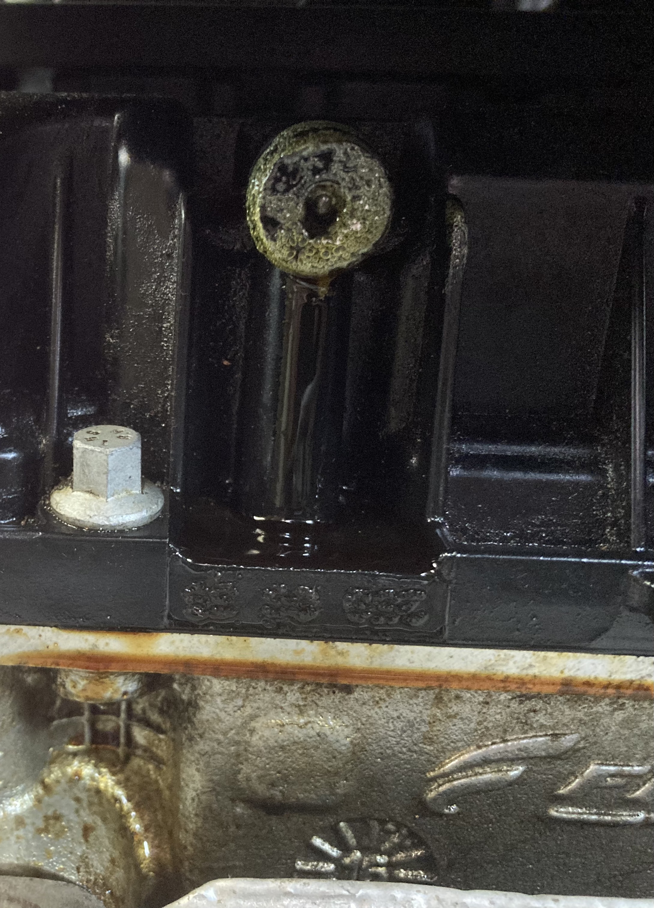

Hi Everyone.
I’ve got a weird small oil leak just under the air box on the cam cover. There seems to be a plastic pipe with stopper in on top of the cam cover. I cleared all traces of oil residue from the front of the engine a few days back & when I’ve checked today there is a small amount around this pipe. Does anyone know what this is for & why it would be leaking oil?
It's a 2017 1.2
Any help much appreciated because I've never seen this on our older pandas.

Can anyone help with this? I tried to seal it with adhesive, but It's still managing to leak out.

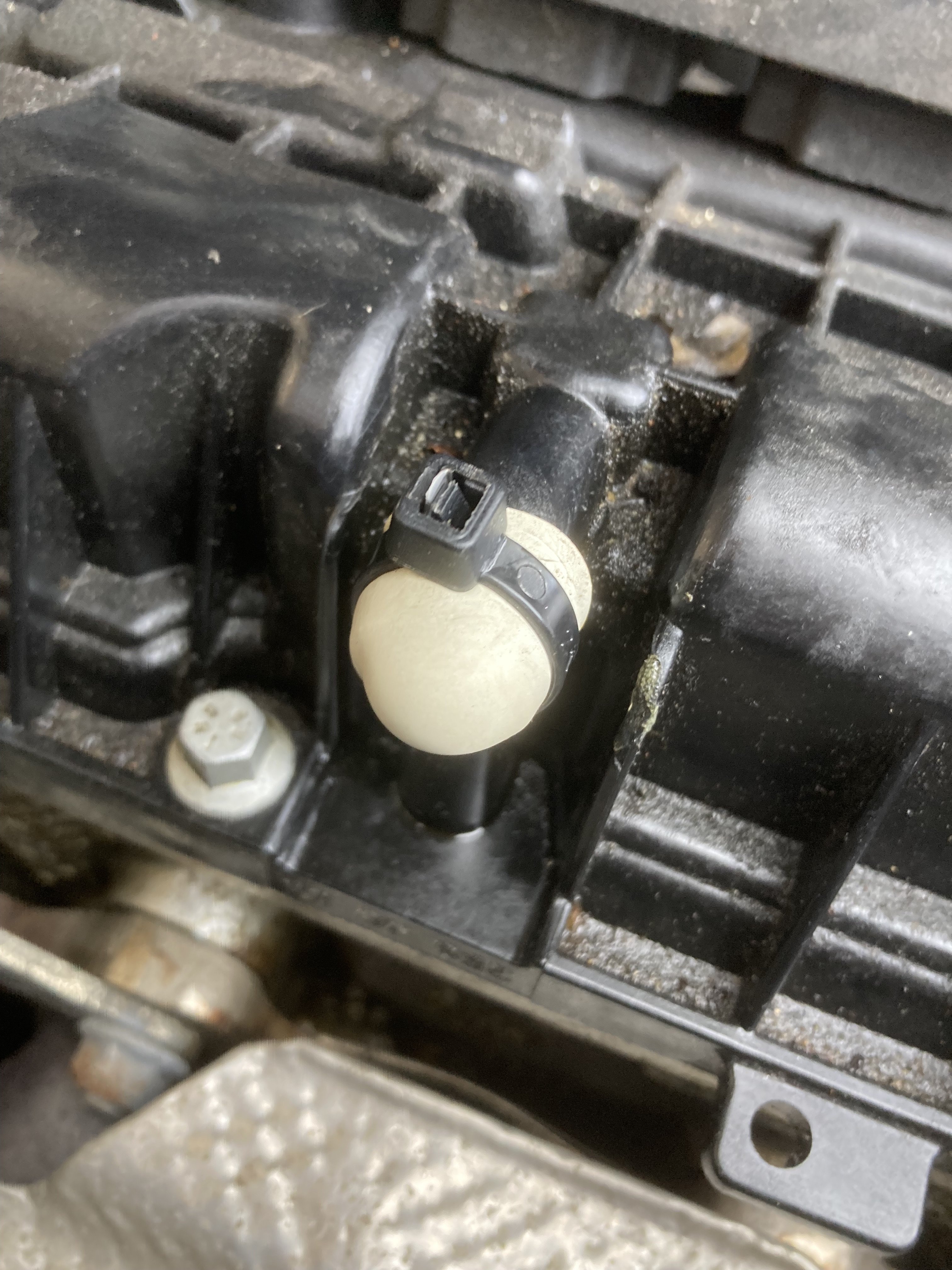

OK. Possibly the most bodge job I’ve ever done. Tried to remove the bung, no go. Tried tapping it back in with a rubber mallet. No change.
So I cleaned it completely, raided my wife's lotions & potions & stole one of her silicone pipettes. Chopped the end off and strong-armed it over the bung. Cable tied in place. Ran the car up to temperature & it didn't swell or build up any pressure. Revved the engine up to 2.5-3k revs for a few mins, same, no pressure build up & no leakage. The silicone is about 3mm thick, so should be tough enough to hold any small amounts of pressure build up nicely. No idea if it will hold. The car has been idling now for 30 mins and still not a drop. Silicone doesn't feel hot, so it feels like it isn't filling with hot oil.

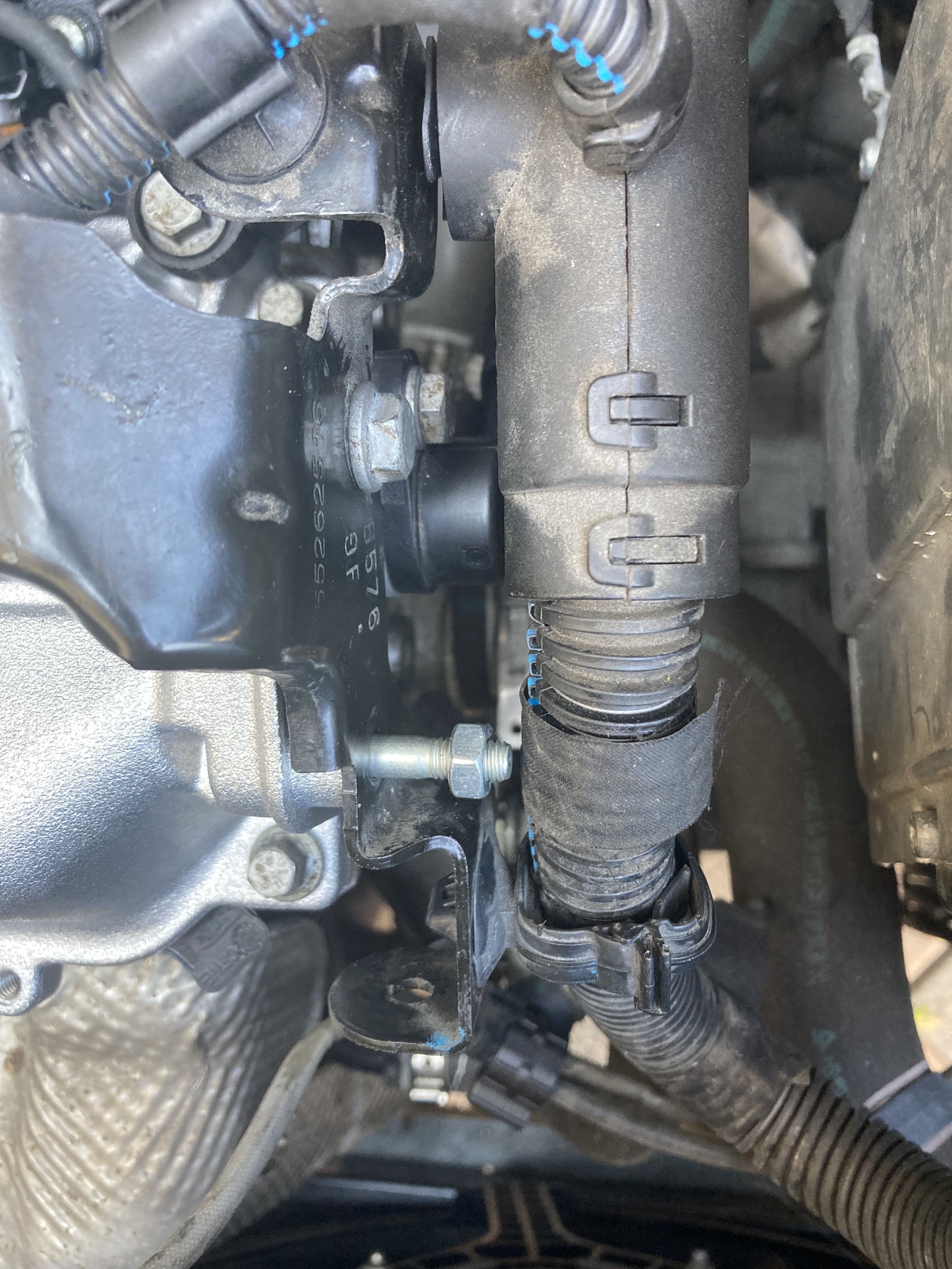

Thought I'd update on this. None of my fixes worked. Fiat suggested I checked all breather hoses, which I checked & actually looked almost pristine inside. A slight amount of mayo on one edge, but clean & clear. Replaced them fully cleared out. The leak got worse & worse until eventually the whole plastic bung on the front gave way & oil was pumped out onto the drive. It's a plastic insert & the bond looks very weak. No screw thread or anything securing it apart from a tiny strip of glue/bond. A definite weak spot. I reckon I lost about 1 litre in the few seconds it was running from starting to popping off. Luckily, my wife was still on the drive & shouted me to stop the engine when she heard the liquid hit the floor.

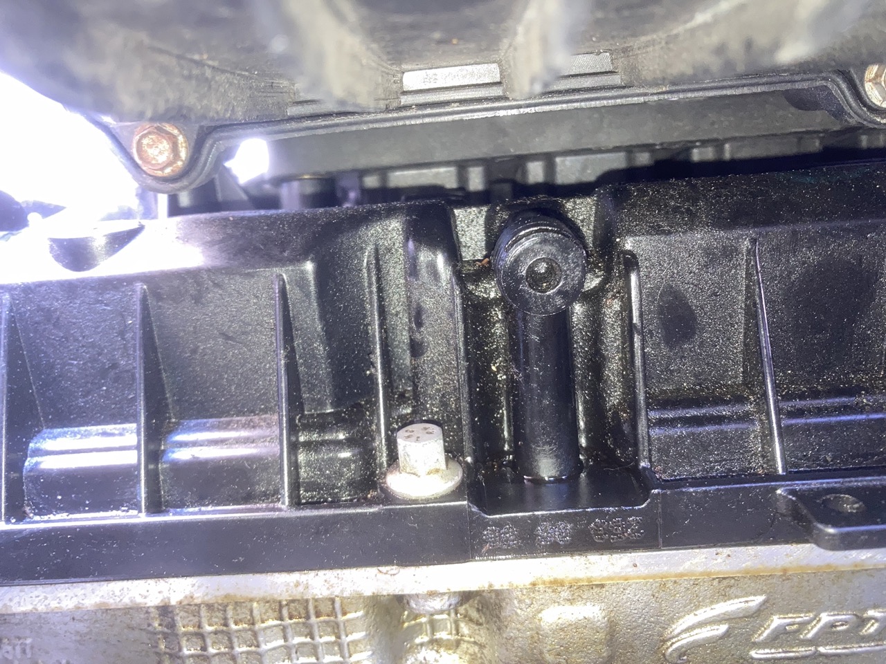

Replacement cam covers seem to be like hens teeth. My mechanic couldn't find an after market in stock & fiat are now supplying. Dealer network say they don't have one in the UK so it's coming in from Italy with a 15-day lead time. So the car is off the road for the next few weeks. This cap actually covers a pretty main oil feed to the top of the cam cover. The oil came out thick & fast under the pressure of the oil pump. If yours is leaking, I’d start looking for a replacement rocker cover. Fiat know of this issue & the dealer stated the replacement part is now alloy. Annoyingly, they don't consider this a recall, as it seems to happen randomly & the parts department seem to think depends on usage. If this has happened at road speed, it would have only taken seconds to lose the entire oil contents of the engine.
Sad state of affairs. This plastic cam cover is a real downgrade from the old alloy cover we had on our 1.2 panda.
Lastly, a picture of the car, laying dead, & the start of the oil clean up & one of the hole without the bung (which is lost somewhere in the engine bay/bumper assembly). The drive is going to take a lot of cleaning to get the oil out.
