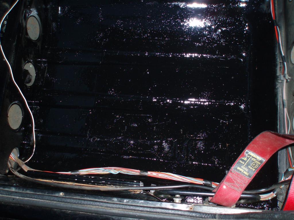

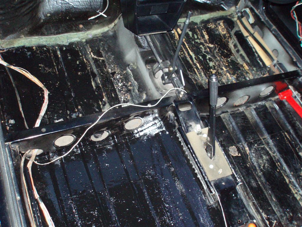

started painted the inside of the uno today, am using black hammerite smooth, not gonna spray it cause no ones going to see it as it'll be covered up with sound deadening and carpet!
started going dark so didnt finish but it'll all be done tomorrow.

Good to here the restoration continues, I'm in a similar situation with my strada, spent 3 days welding and have atleast another 3 days more to do. Need to take some time off.
Is that a hole in the floor I see? Have you tried something like Hammerite Kurust? use a wire brush on the floor, paint with hammerite Kurust, then paint with smoothrite.
