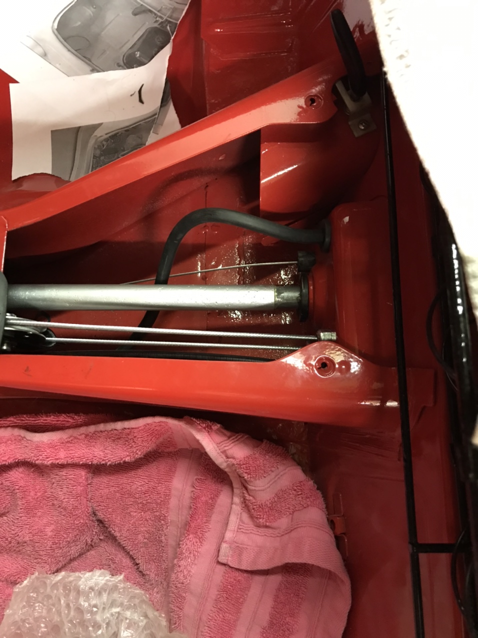

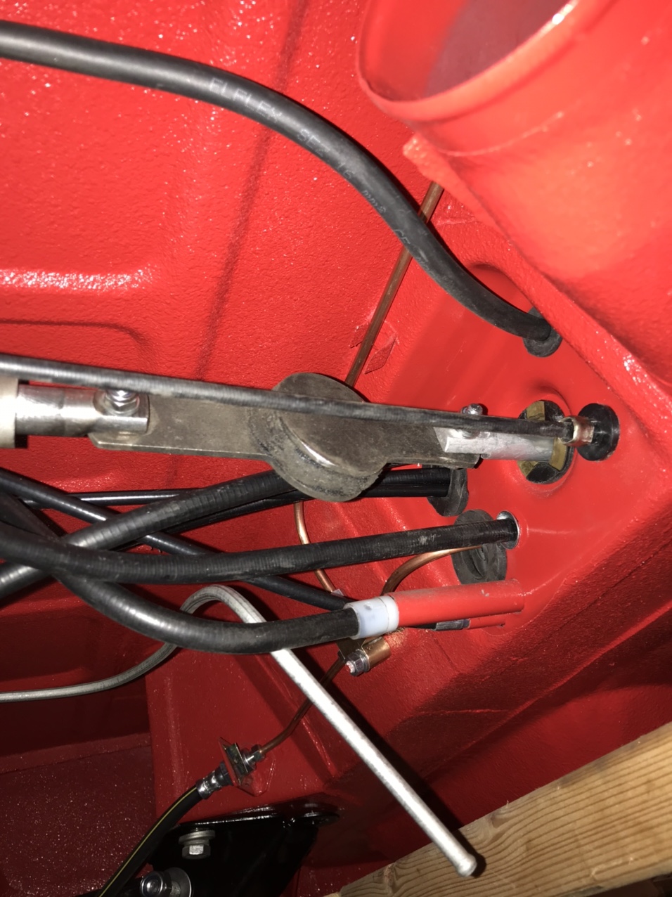

Hit a slight problem.
When I connect the gear linkage up the gearstick will not go forward as it hits the front tunnel section.
It would appear the gearbox is now about 15-20 mm closer to the middle of the car and the linkage bar is being pushed too far forward.
I didn’t have this issue when I fitted a 126 engine and box in the L.
I cant move the engine back or forward so there must be a difference in length between the F/L flywheel housing and a 126 housing?
The only thing I can think of is to shorten the flexi joint between the box and linkage.
Anyone else come across this issue?

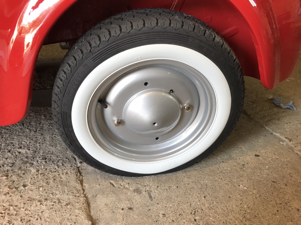

Aluminium rims were quite dull. I have buffed the left one up although it looks darker in the photo it’s a lot shinier than the other one.
Just need to get some bulbs and then try and fit those stupid clips.

mmmmm those are nice Bianchina wheels :D:D:D:D
but it does of course as we all expect look very nice
don't worry the centers will be covered by hub caps

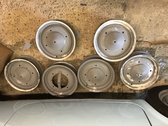

interesting subject that.
What should be on a 1964 D?
I have found quite a few D's with my wheels on. Including the original photos of my car when it was in Italy.
Saying that I have also found images of the other type.
I also found autobianchi with both my wheels and the ones you suggest are D's.
So what is right and what is wrong?
Were there different types depending on where they were made?
Personally I think my ones look better than the other type.:)
What should be on a 1964 ...........................
I asked the question a long time ago when i found a "domed" wheel as a spare, was told the domed wheels were Bianchna as they were not really made by Fiat but Autobianchi and designed to be "more upmarket" so different..
the Normal Early wheel there are still two types (or more) the difference being the curvature of the outer rim... that may be due to a change in manufacturer, the very lip of the rims more "turned over" on some wheels...
I can find no reference to any change over...
My replacement D Parts book only contains one wheel type which is a representation of the "Normal" early wheel.

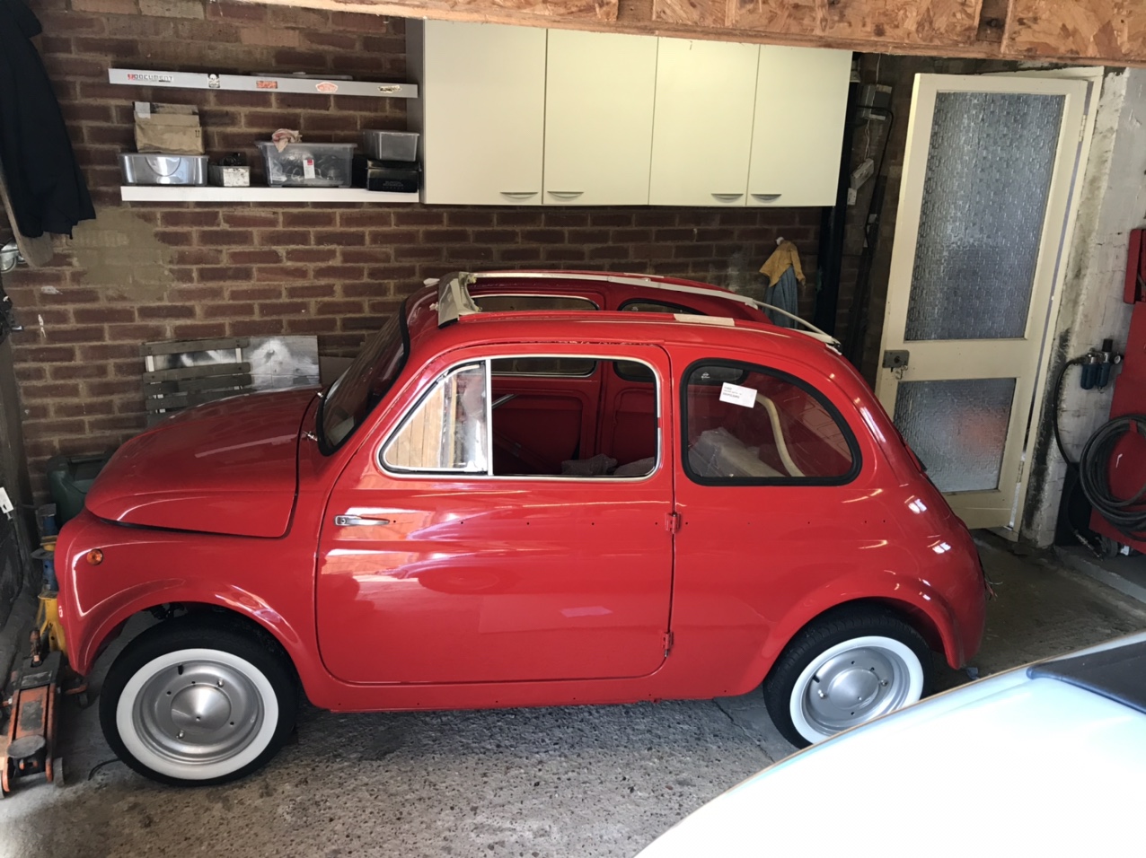

Front and rear lights and bumpers all fitted.
Just found out the D rear view mirror has a different light bulb so need to find another replacement.
Can anyone tell me if there is a part missing where the wires come in at the back?
It appears that there should be some kind of plug that the wires fit in and then fits the contacts.
For now I can bend the contacts to fit the wires.

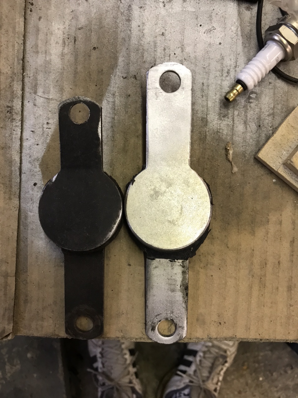

Door rubbers have been glued on. They were supposed to have 5 clips along the top frame but the clips are not deep enough.
Door catches all fitted and also the check straps.
They were originally held on by self tappers but I have fitted 5mm inserts and used screws for a bit more strength.
Once the glue has gone I can finish lining up the doors.
Looking really good mate .I see your check straps don’t have the metal plates each end that grip the strap to the car more evenly .
