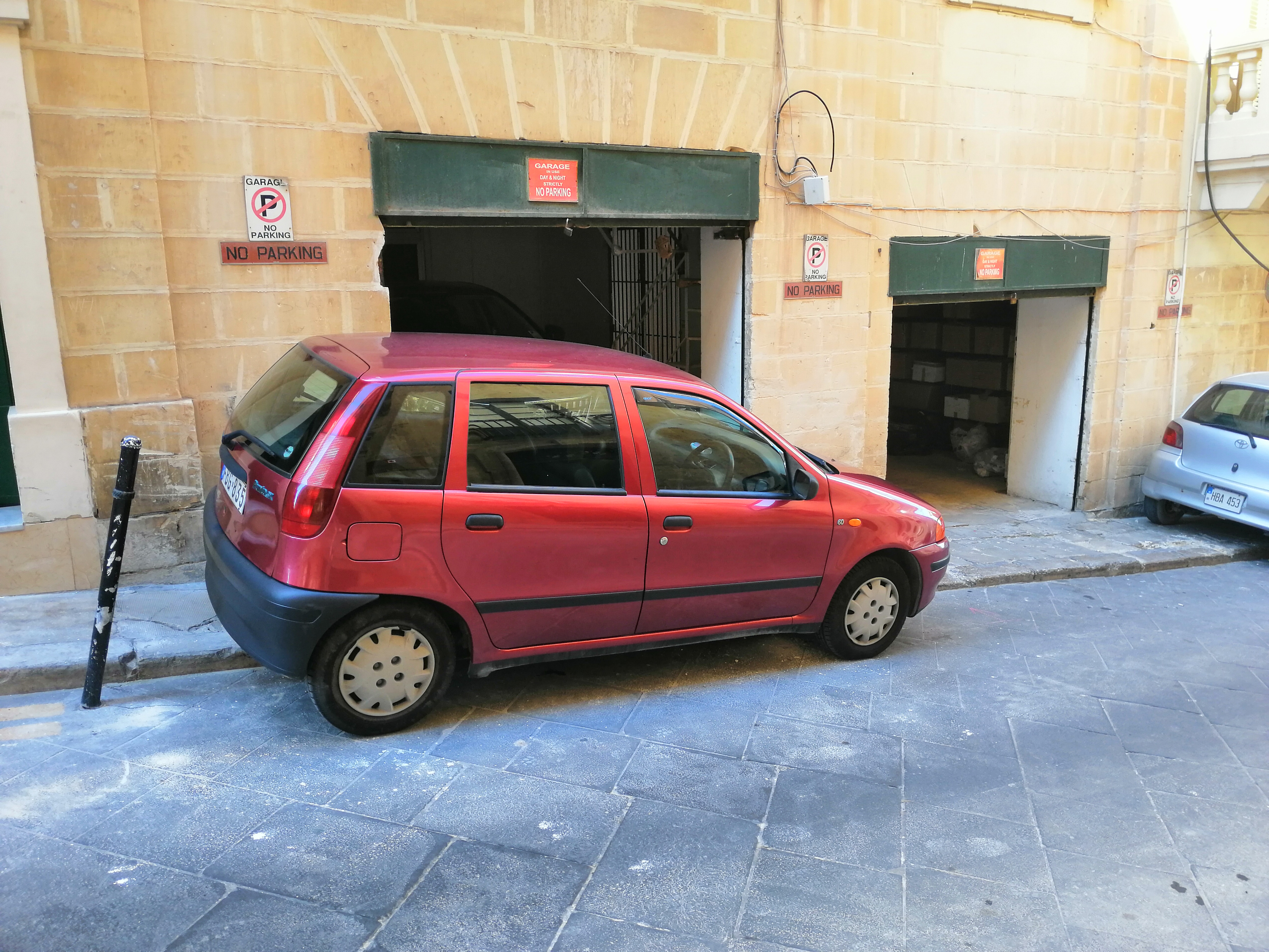

Hi there. My MK1 Punto 60 drives and runs flawlessly however at a cost. It guzzeles fuel as much as my mini cooper S! That is about 40 miles per €10. I've recently lent the car to my sister who has also noticed it's high consumption. We were thinking of selling it off and buying something better however I would like to fix it if possible as it is a sweet little car and still in very good condition for its age with relatively low mileage. The car is a 1.2 SPI 60 bhp. Since it does not support OBD2 I am unable to have the luxury of hooking it up to my phone to narrow down the fault - if any! My suspicions are maybe temp sensor or possibly faulty lambda however before I start replacing parts I want to see if anyone had the same issue. P.s the car does not misfire and runs and idles flawlessly.

I also notice you are parked in a very hilly area from the photo.
