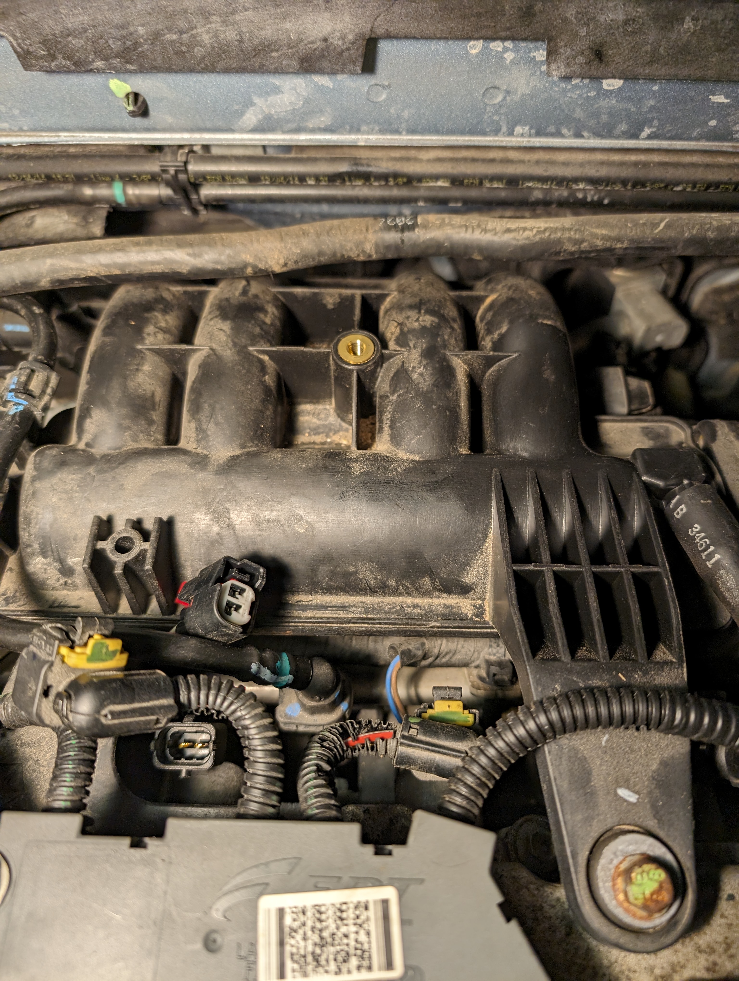

A rodent chewed through the wires to the first cylinder fuel injector on my wife's 500c. I am trying to remove the harness to fix it however I am not sure how to remove this item (please see picture). If it is too cumbersome, I may just cut the plastic clip holding down the harness at cylinder 1 to lift that end out and splice on the new connector.
Thank you in advance,
Shawn
I was able to cut the plastic clip that held the wiring harness down at injector 1 and this allowed me to maneuver the cable to fix. I did not have to remove the manifold which would have been a huge pain for this fix. Chugging stopped, reset the codes and so far everything is working as normal.
