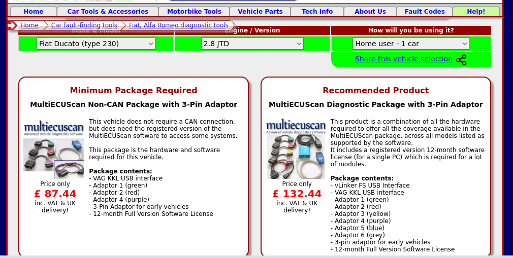

But my question relates to devices that can be used to erase the codes without having to go to a garage. Particularly because I am presently in Germany with my Hymer which has gone into limp mode and I can't find a garage which has the equipment to connect to my old 3 pin OMDB socket, not even the Fiat garage! I just want to reset the codes so I can drive back to the UK.
I have seen people mention Fiatecuscan software. Will this work with my 2001 Ducato with it's 3 pin plug and where do I get it? Someone also mentioned a Snapon Ethos Edge Diagnostic Device. Does anyone have experience with this device. Would it fit a 3 pin plug?

you need a special adaptor available from Gendan in Swansea.
now what you need depends precisely which engine.

Thanks for your comprehensive reply. Very helpful. I will order the multiecuscan package and the ELM 327 device from Ebay and have it sent to Germany. I have a Windows laptop with me so hopefully that is enough to reset the codes.

As much as we all like to save a couple of bob in this case i think the one stop shop of Gendan could save a lot of grief. The adaptor i got from Gendan was of a much better quality than ebay sourced. This assumes Gendan can supply into germany. Ps i have no connection other than as a satisfied customer.

As a minimum your OBD scanner will require a separate 12V supply. As I understand it, the x230 OBD port has only two wires connected, which will have to be signal, and reference earth.
Multiecuscan translates Fiat specific codes, as does AlfaOBD. To quote @Ocwobio "it speaks fluent Fiat.".

yes you need a laptop and the software and appropriate adaptors.
