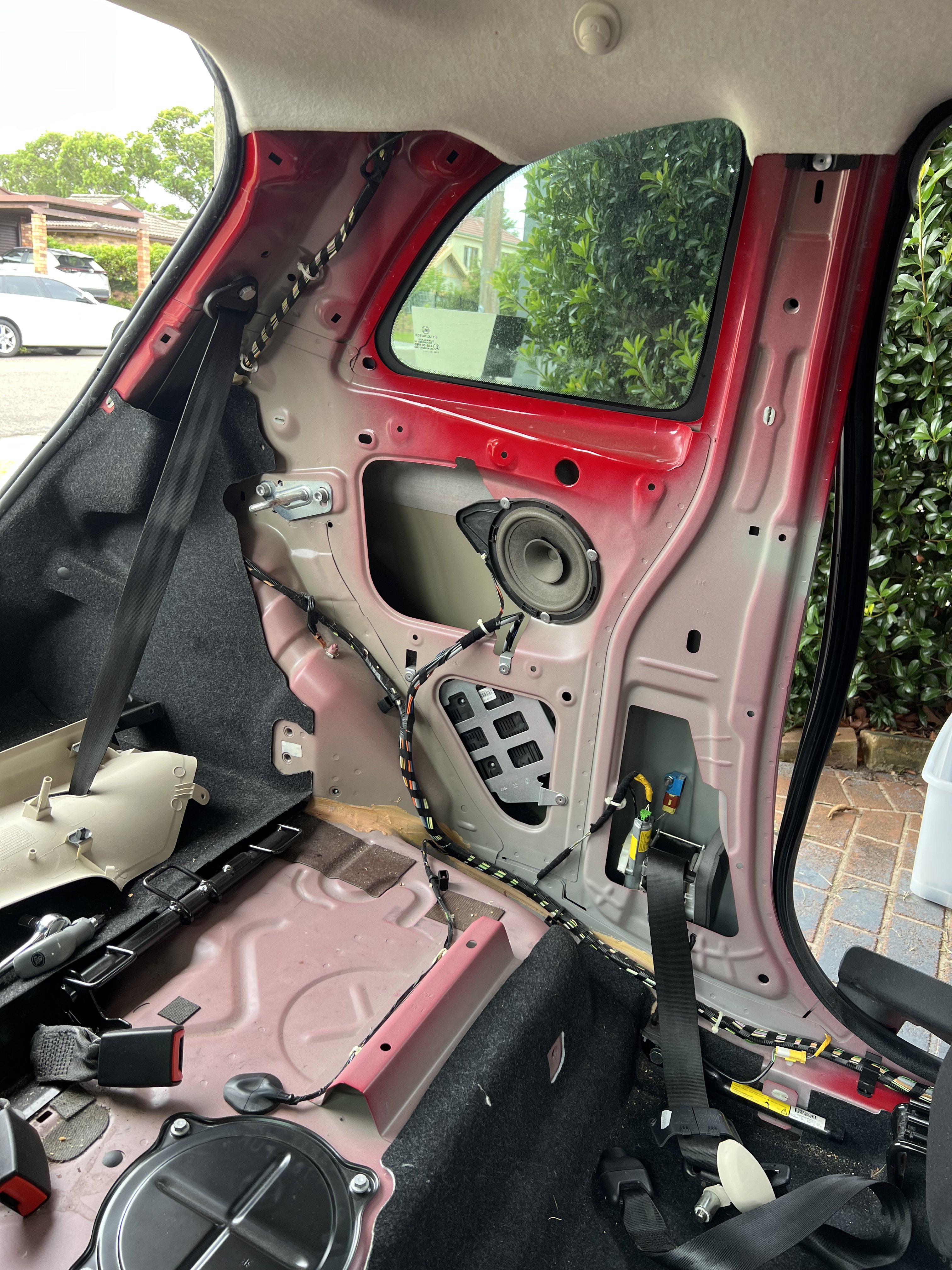

At that point I decided this was it - last resort before going to an auto-electrician. I stripped out the back of the car and disconnected the wiring loom from the B&M module. A few days later, I went away on holiday. The car sat for 6 days unused and I've jumped in today and started it. It fired up instantly. The drain problem would have absolutely killed the battery after 6 days on the driveway so I'm calling it fixed, and most definitely linked to a dead B&M module.
