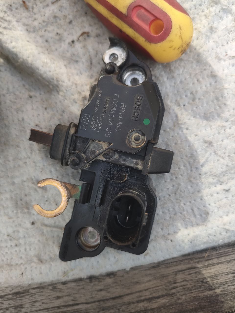

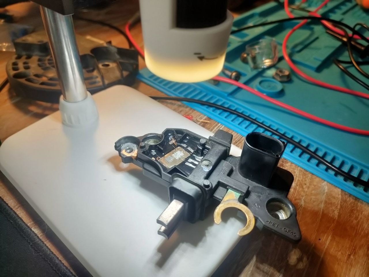

Yes, this works and starts the alternator. But I tried it with just 12V, no lamp in between. Through the multimeter it didn't work, it is faulty (probably blown fuse), but I will try again with another one. The problem with this fix is that I will not get a warning light when the alternator fails in the future because there will always be 12V on the
Have you loaded it up when it's up at 14v?
I did, when I put all lights on and put the blower at max the voltage did drop to about 13.8-13.9V with the new regulator. Otherwise it will stabilize around 14.2V.

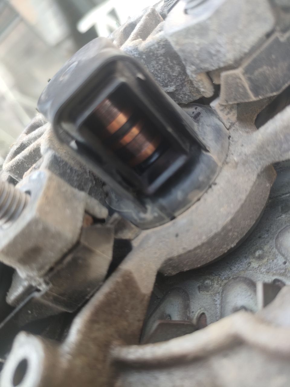

So, I was considering pulling the alternator out again and decided to rule out any wiring issues despite not measuring any resistance between the D004 connector and D+, and the D004 and the BCM under the dash. I then did feed 12V from the battery + next to the relay box into the D004 connector and the alternator fired up. I also bridged the wire between the 2 sides of D004 to rule out any issues in the connection there.
With the ignition on I measure 9.5V on the D+ wire with the connector off the alternator, plugged in I now get 1.6V. Before, with the old regulator, I got 0.7V so this is quite a difference. Also, with the old regulator revving the engine slightly would start the alternator, with the new one, that doesn't work and I do get a battery warning light after some time. So this is odd...
So, next thing I want to do is take the BCM connector apart and reconnect it without the outer housing, this way I can get a needle in the D+ pin hole and run a patch cable straight to D004. If this works and fires up the alternator then I'll have to run a new wire to fix it and then the alternator has nothing to do with it in the end...
Option 2 is that the alternator is faulty on the rotor or stator coils and the BCM can't provide enought current to get it going, but putting 12V on it can start it...
