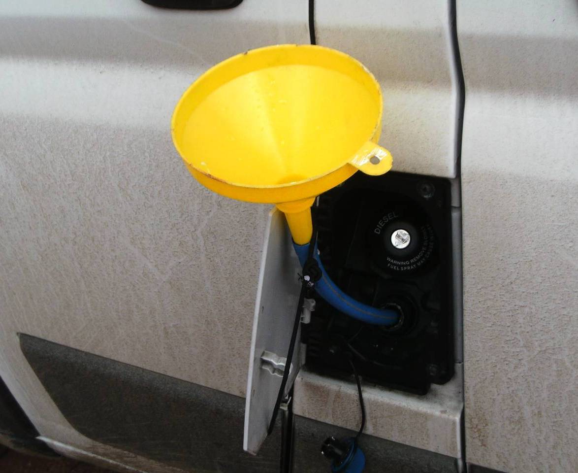

There is a flap in the filler pipe that has to be pushed open before you can put adblu in
The filler nozzle at a filling station pump should do it
But some of the nozzles supplied with adblu containers are not long enough
I fill mine with garden hose pushed on the end of a funnel, fastened to the bodywork gate with elastic
