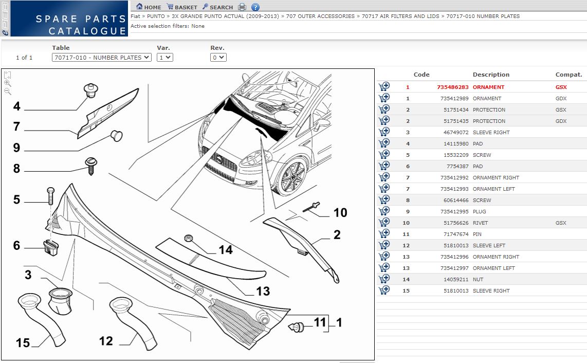

Hello everyone ,
Does anyone know what is this part called so i can try and get a new one since mine has the rubber cracked and water gets under it .
Doesn't seem hard to replace just remove the wiper arms and some screws .
Ty .

Look on ePER. This has been asked before
Same part 2006 / 2016

In the UK it's known as a scuttle panel. Some European sites call it a smoke deflector.
They are different depending on whether the car is left or right drive. Diagram below is for left drive (GSX), part number 735486283
One here for 68 EUR. https://augustin-group.com/p/smoke-deflector-6473559oe
