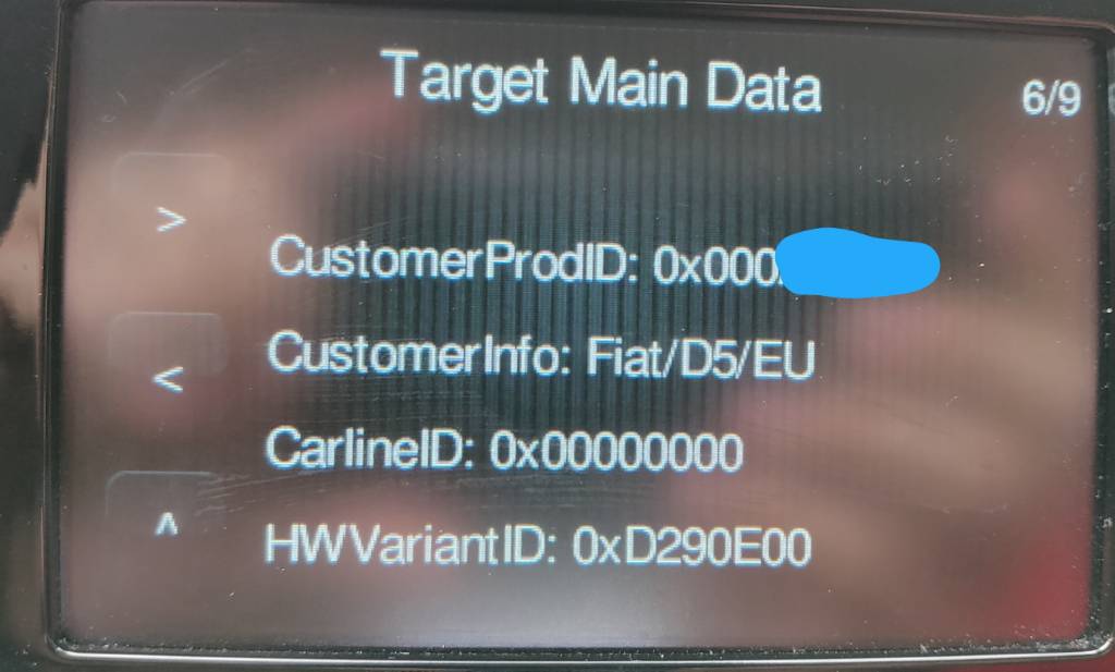

For the Fiat 500L, it seems that if we find a way to change the hardware map from the non nav to nav it could be possible assuming the space requirements are there and the partition layout is the same. I do have doubts it will brick so not too sure to try it.
It probably is possible if the uconnect unit is off the same model (330 and then the B/C/etc.)
Non Nav 500L Models
Code:
        <HARDWAREMAP>000100040102-05280e00 VP2_NAV_DUMMY</HARDWAREMAP> <!-- 330 C1/D1/D2 ROW -->
        <HARDWAREMAP>000100040102-0d280e00 VP2_NAV_DUMMY</HARDWAREMAP> <!-- 330 C1/D1/D2 ECE -->
        <HARDWAREMAP>000100040102-0d280e01 VP2_NAV_DUMMY</HARDWAREMAP> <!-- 330 D1/D2 ECE DAB -->
        <HARDWAREMAP>000100040102-05290e20 VP2_NAV_DUMMY</HARDWAREMAP> <!-- 330 C1/D1 NAFTA COMPASS (WO ETH) / 637 D1/D2/D3/D4/D5 NAFTA COMPASS -->
        <HARDWAREMAP>000100040102-05290ea0 VP2_NAV_DUMMY</HARDWAREMAP> <!-- 330 C1 NAFTA COMPASS -->
        <HARDWAREMAP>000100040102-05290ea2 VP2_NAV_DUMMY</HARDWAREMAP> <!-- 330 C1 NAFTA SDARS COMPASS -->
        <HARDWAREMAP>000100040102-05290e22 VP2_NAV_DUMMY</HARDWAREMAP> <!-- 330 D1 NAFTA SDARS / 637 D1/D2/D3/D4/D5 NAFTA SDARS COMPASS -->
        <HARDWAREMAP>000100040102-0d290e01 VP2_NAV_DUMMY</HARDWAREMAP> <!-- 330 D4/D5 ECE DAB RVC -->
        <HARDWAREMAP>000100040102-0d290e00 VP2_NAV_DUMMY</HARDWAREMAP> <!-- 330 D4/D5 ECE RVC -->
        <HARDWAREMAP>000100040102-05290e00 VP2_NAV_DUMMY</HARDWAREMAP> <!-- 330 D4/D5 ROW/JAP RVC -->
        <HARDWAREMAP>000100040103-05280e00 VP2_NAV_DUMMY</HARDWAREMAP> <!-- 330 C2 ROW -->
        <HARDWAREMAP>000100040103-0d280e00 VP2_NAV_DUMMY</HARDWAREMAP> <!-- 330 C2 ECE -->
        <HARDWAREMAP>000100040103-0d280e01 VP2_NAV_DUMMY</HARDWAREMAP> <!-- 330 C2 ECE DAB -->
        <HARDWAREMAP>000100040103-05290e20 VP2_NAV_DUMMY</HARDWAREMAP> <!-- 330 C2/D3/D7/D8 NAFTA -->
        <HARDWAREMAP>000100040103-05290e22 VP2_NAV_DUMMY</HARDWAREMAP> <!-- 330 C2/D3/D7/D8 NAFTA SDARS -->
        <HARDWAREMAP>000100040103-0d290e01 VP2_NAV_DUMMY</HARDWAREMAP> <!-- 330 D6/D7/D8/DA/DB/DF DAB RVC -->
        <HARDWAREMAP>000100040103-0d290e00 VP2_NAV_DUMMY</HARDWAREMAP> <!-- 330 D6/D7/D8/DA/DB/DF ECE RVC -->
        <HARDWAREMAP>000100040103-05290e00 VP2_NAV_DUMMY</HARDWAREMAP> <!-- 330 D6/D7/D8/DA/DB/DF ROW/JAP RVC -->

By changing the hardware definition variable to the VP2_NAV, this skips out the line of codes below:
Code:
        <!-- Dummy definition -->
        <HARDWARE Hardware="VP2_NAV_DUMMY">
          <PROJECTMAP>* DUMMY_PRJ</PROJECTMAP>
          <PROJECT Project="DUMMY_PRJ">
            <DOWNLOAD_SCRIPT>
              <COPY>
                <COMMAND>INSTALL_FRAGMENT</COMMAND>
                <OPTIONAL>0x4010108</OPTIONAL>
                <FILENAME>MMP_AUTO_4010108_DUMMY.FRG</FILENAME>
                <PATH>/cddos/AUTO/4010108/VP2_NAV_DUMMY/DUMMY_PRJ/PROG/4010108_DUMMY.FRG</PATH>
              </COPY>
              <COMMAND>FINISHED_ECU</COMMAND>
            </DOWNLOAD_SCRIPT>
            <FRAGMENT_INSTALLSCRIPT>
              <COMMAND>FINISHED_FRAGMENT</COMMAND>
            </FRAGMENT_INSTALLSCRIPT>
          </PROJECT>
        </HARDWARE>
      </FRAGMENT_ID>
See how the difference is only VP2_NAV_DUMMY. This suggests if we can change the variable name to the VP2_NAV for the hardware, it should actually be possible! However, there are some models which are not compatible with changing them to the VP2 nav as there isn't ones for them. So it actually depends on the model variant you own.

I am sorry for the late reply but the firmware packages are universal for all uConnect 5' models released by Fiat, the installer will detect your hardware model and install the relevant modules that your infotainment system has (e.g. For example some have DAB, Satellite Radio, SDARS, FM, NAV, uConnect LIVE) and the installer will just install the relevant features.
It does this by checking the variable parameter in the configuration and in my case the D5/EU D290E00 will install the dummy navigation firmware as it has no navigation. If a physical antenna was present on the back, we could rename the partition and install the tom-tom.
The outside temperature has been present on the other firmwares as well for my hardware variant. The system seems to be snappy and I have no usability issues at all.
