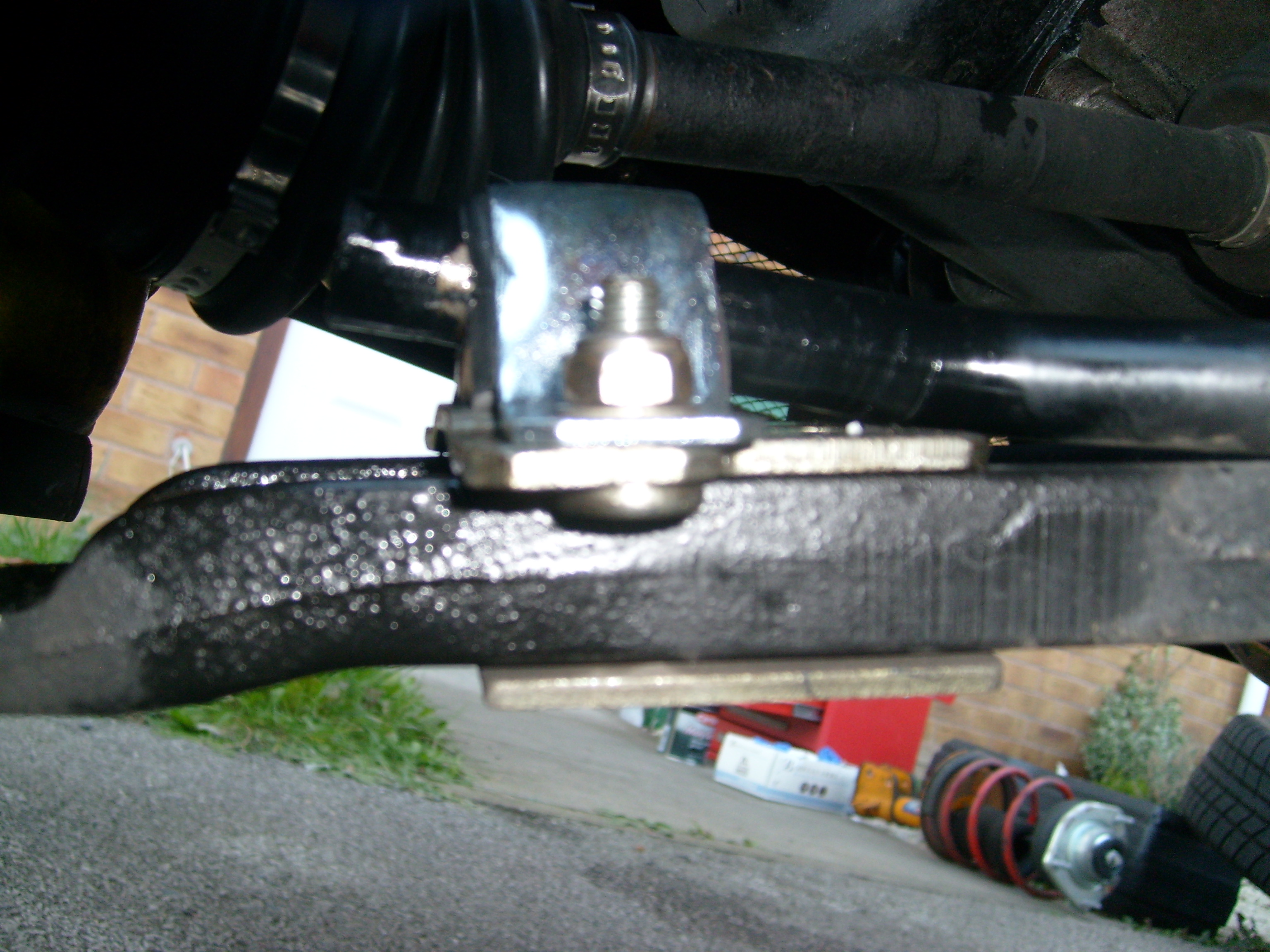

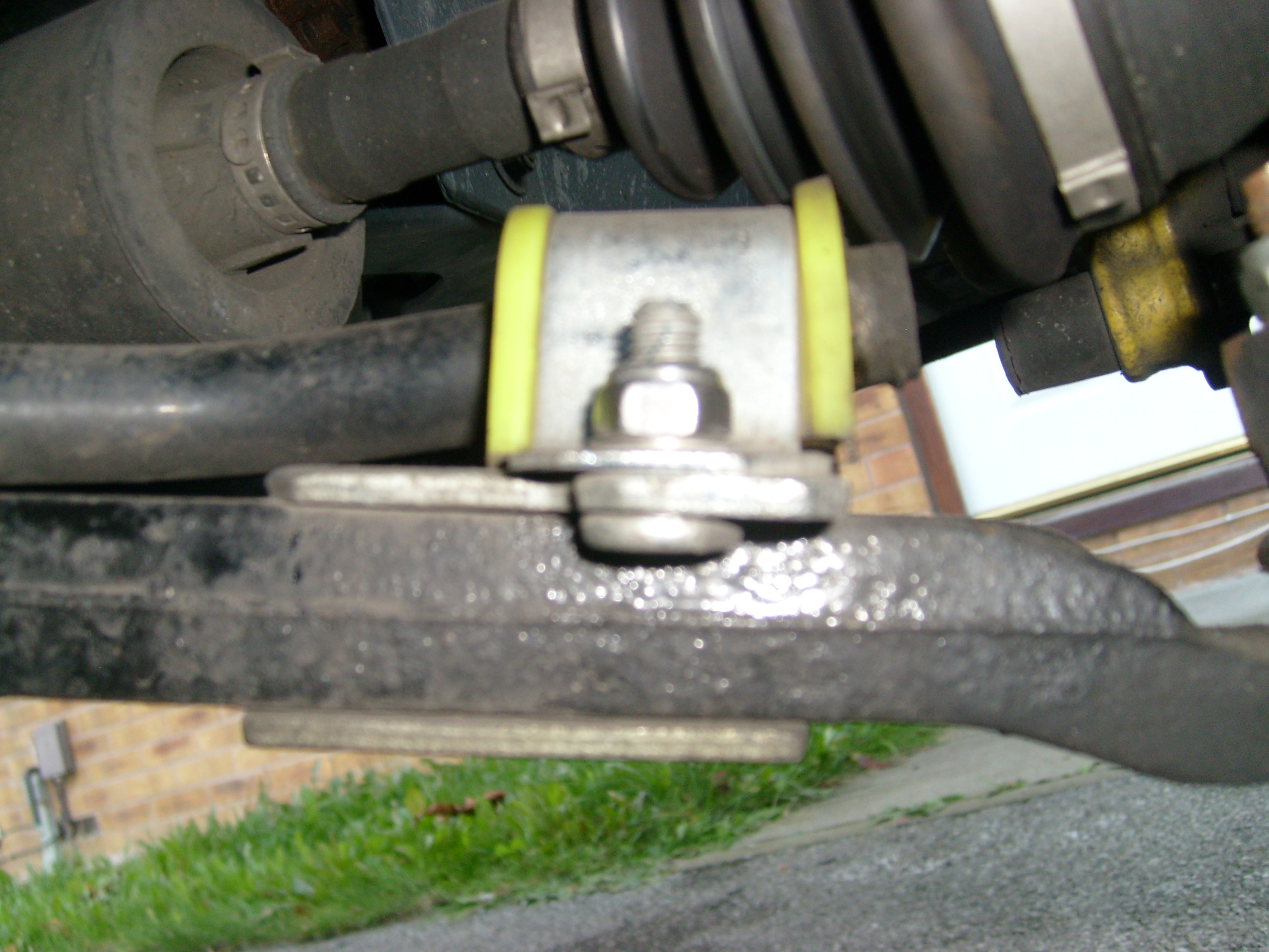

I wonder how long Stronglex have known about this issue?
the polish guys at stongflex said they have made a modified set of brackets as they had alot snap
If It's been several months, Strongflex should have notified customers who purchased the earlier version of a potential problem and offered a replacement.
If I had been travelling at higher speed around country lanes in the wet and the bracket failed in a bend, The car might have spun out due to sudden weight transfer and the ARB contacting the drive shaft.
Also, If this has been a known problem within the cross channel tuning sector then how have we missed it?
The funny thing is, When I was fitting the brackets, I thought they looked a bit thin for the design.:mad:

Dont suppose you know the old and the new measurements do you Andy? cant be bothered to take mine off, especially if they are fragile :p
my new brackets were definately thicker than the first set same shape etc etc just thicker guage(y)(y) my old set is in the bin weeks ago and the new ones are on the car.i can put some pics up if required???(y)come to think of it they were slightly taller but i put that down to the old ones being a bit twisted
I would say that the new one would be slightly taller
Yes, But http://strongflex.vot.pl/images/diagrams/fiat-sc-clip.png the picture shows internal dimension measurement...Which would not change if it is to fit the original bush even if 10mm thick metal was used for the bracket.
Something is missing here.
Like simple calculations in engineering? Have Strongflex forgotten these dimentions or is it a trick question?
All i sent to them was i had bought a set 18 months previously and the arb brackets had snapped and did they sell replacements and the reply was that they had problems with original sets and to forward my address and new ones would be sent that day and they were(y)
i will certainly use them/recommend them to anyone and i prefer them to powerflex as powerflex dont seem quite as hard as the strongflex items:D:D
