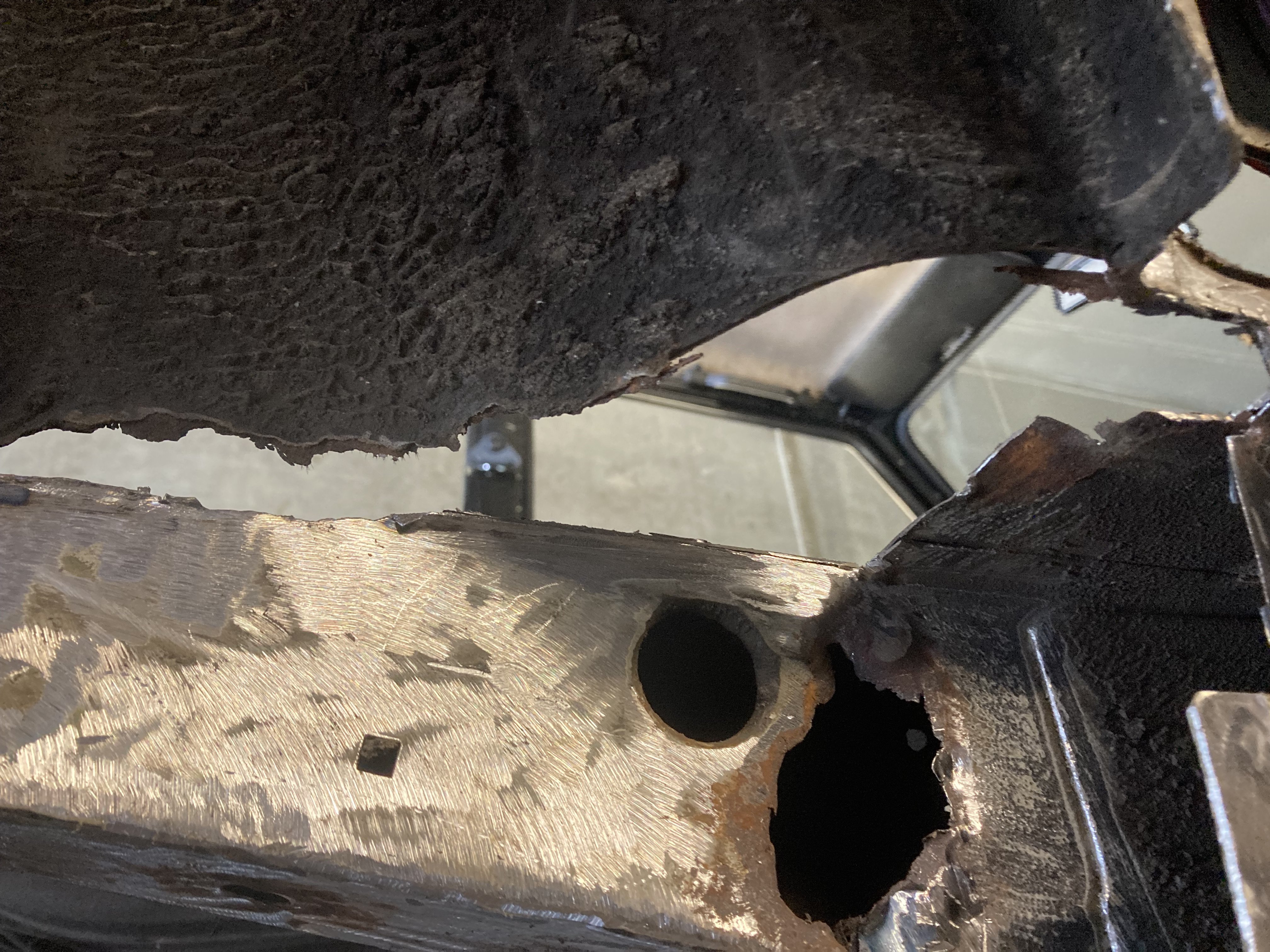

She had never had any advisories for rust, other than one in 2010. The underseal was the original, as was the paint. Unfortunately there was nothing in the middle! As the previous owner only covered a few hundred miles a year I suspect the previous MOT’s were merely a glance over her and a pass given each year.

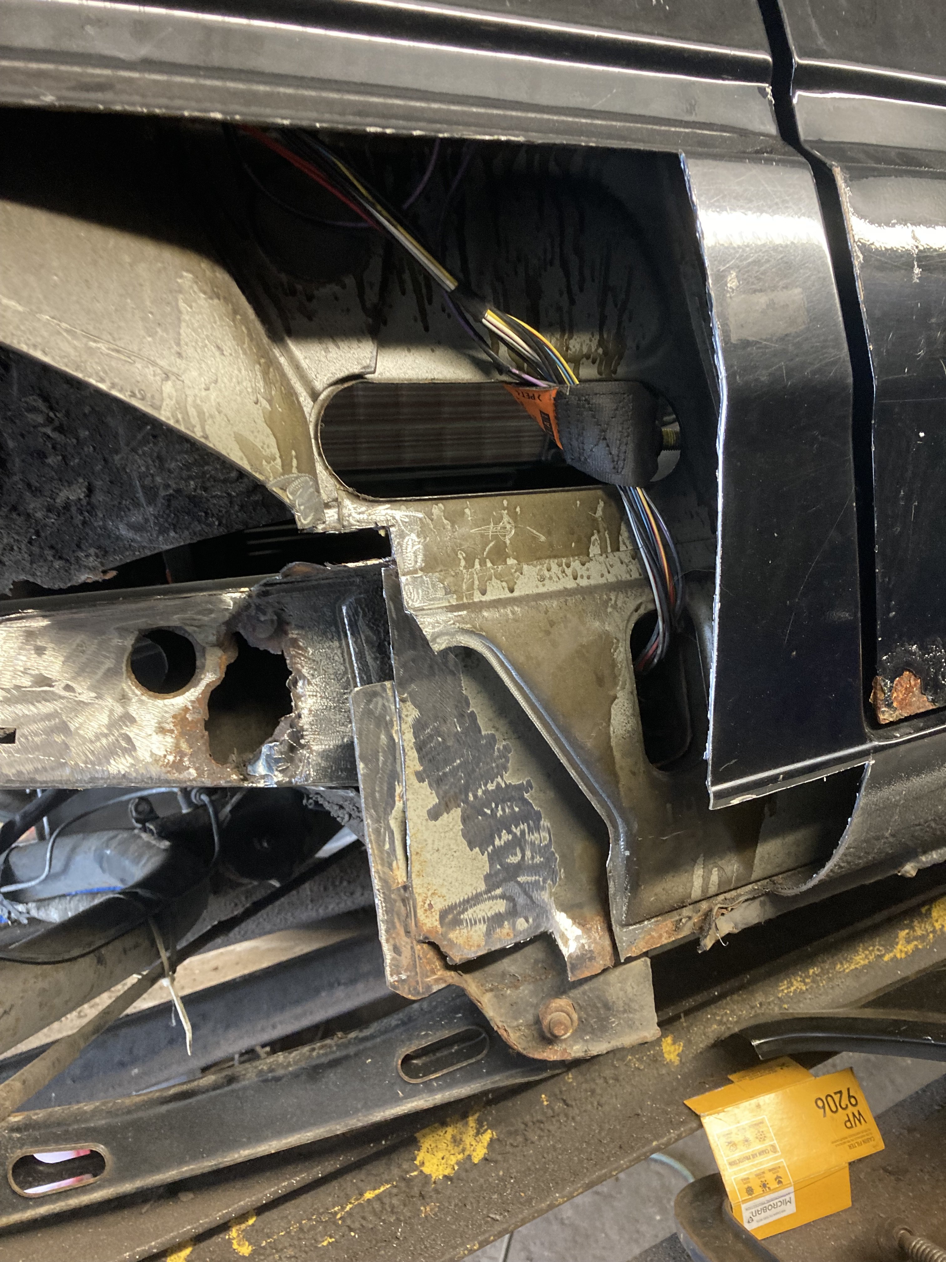

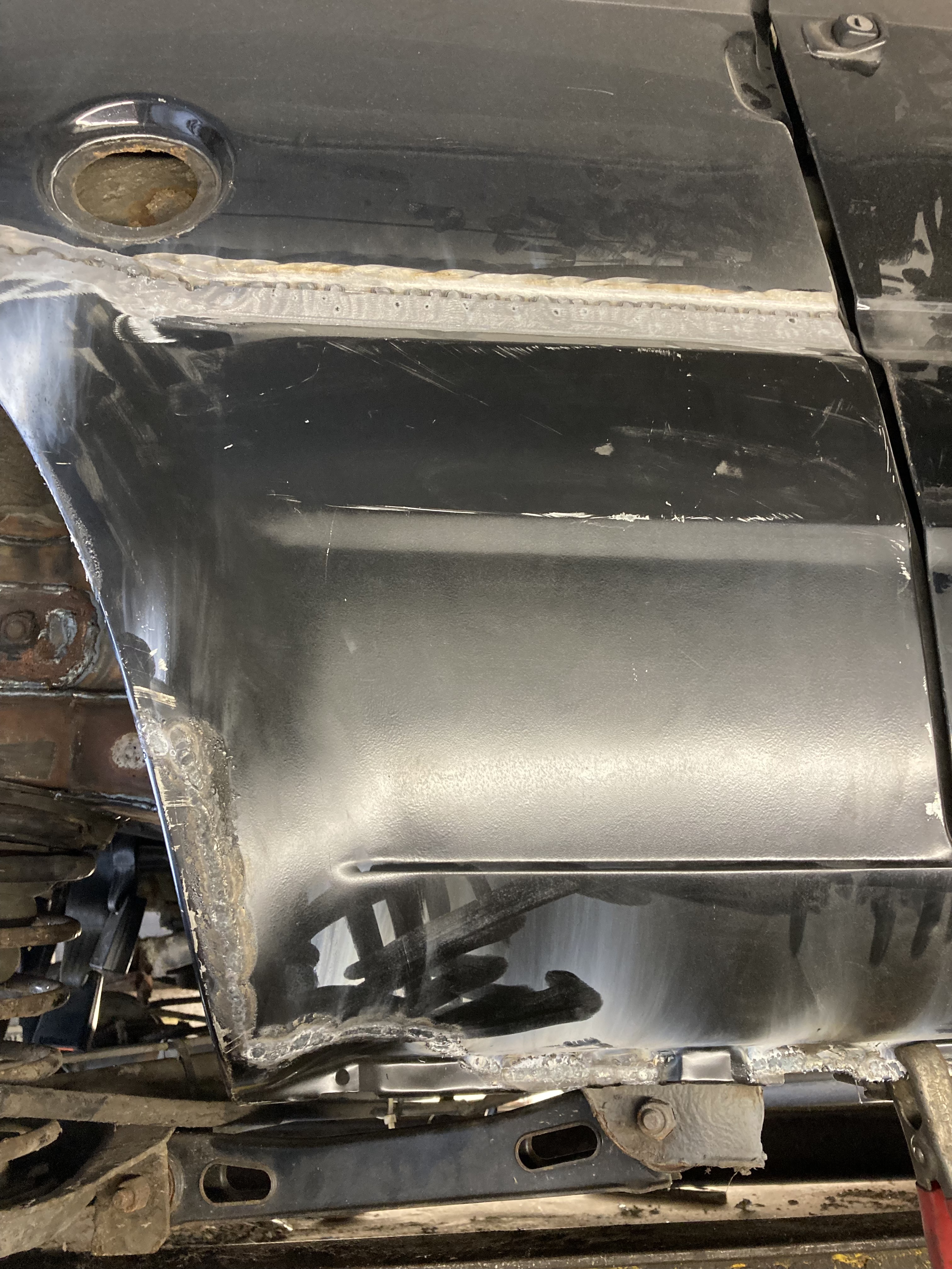

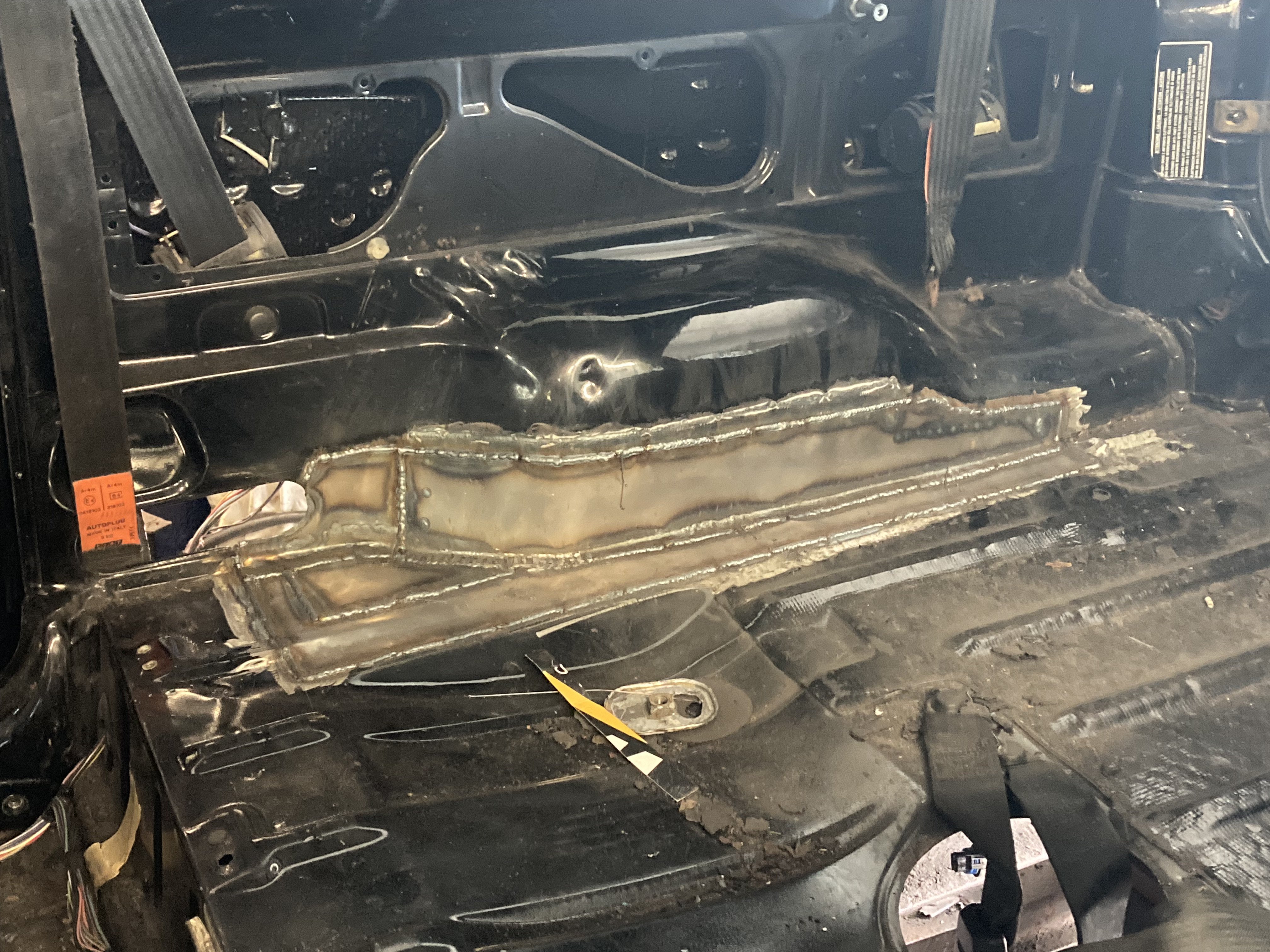

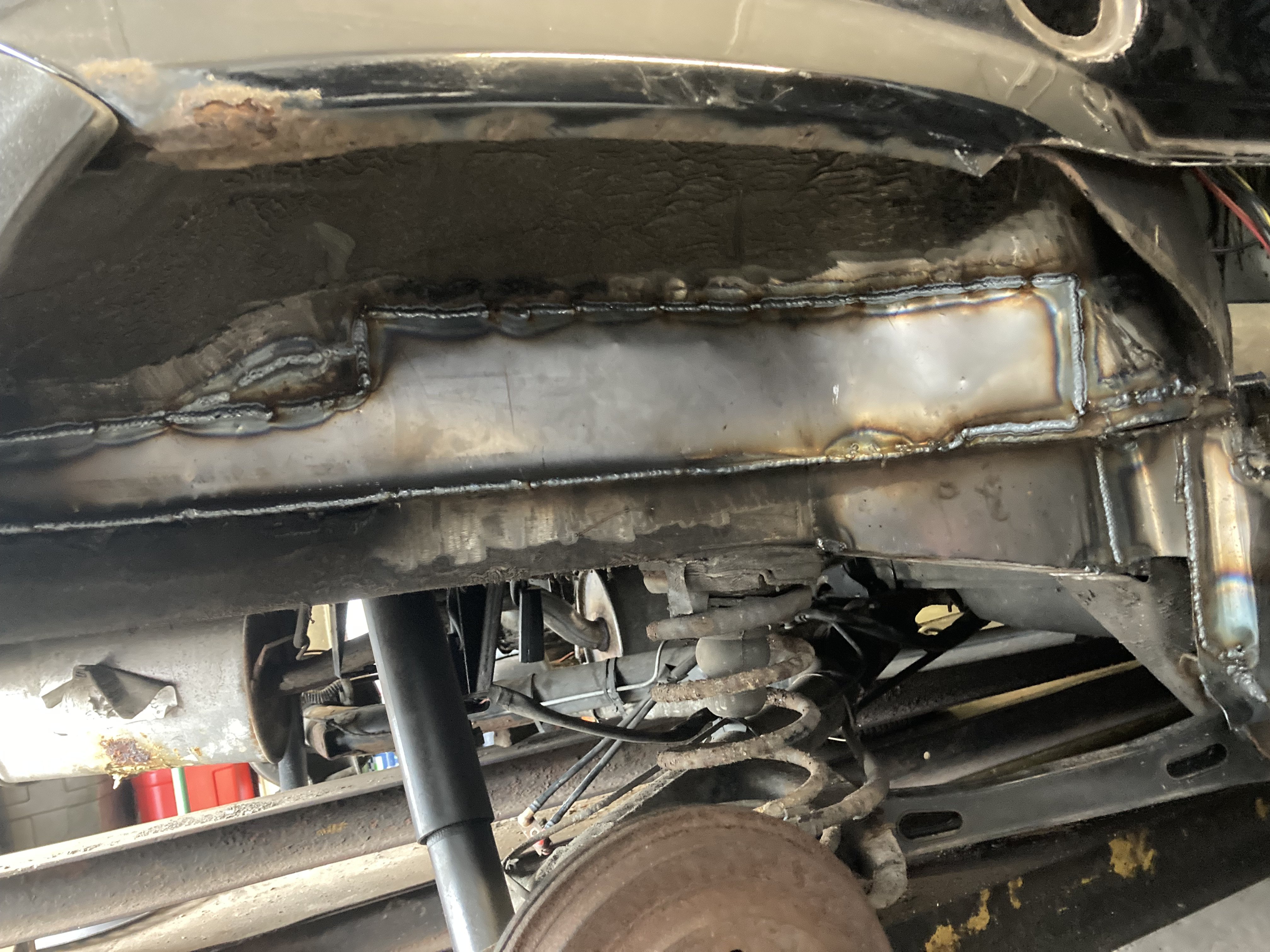

So, the decision was made to bite the bullet and have all the rust cut out and new metal pieces fabricated and replaced, along with new sills on both sides. I’m sure a lot of non Panda people wouldn’t have gone to the effort and would have just sent her to the great scrapyard in the sky, but you all know how these little cars get under your skin and the Panda Virus is difficult to shift one you catch it
Luckily I have a very understanding local independent garage who have been happy to take this on as a project (they are in to their classics) and work on it when they have had spare time, which has kept the costs down significantly and I have helped where I can.

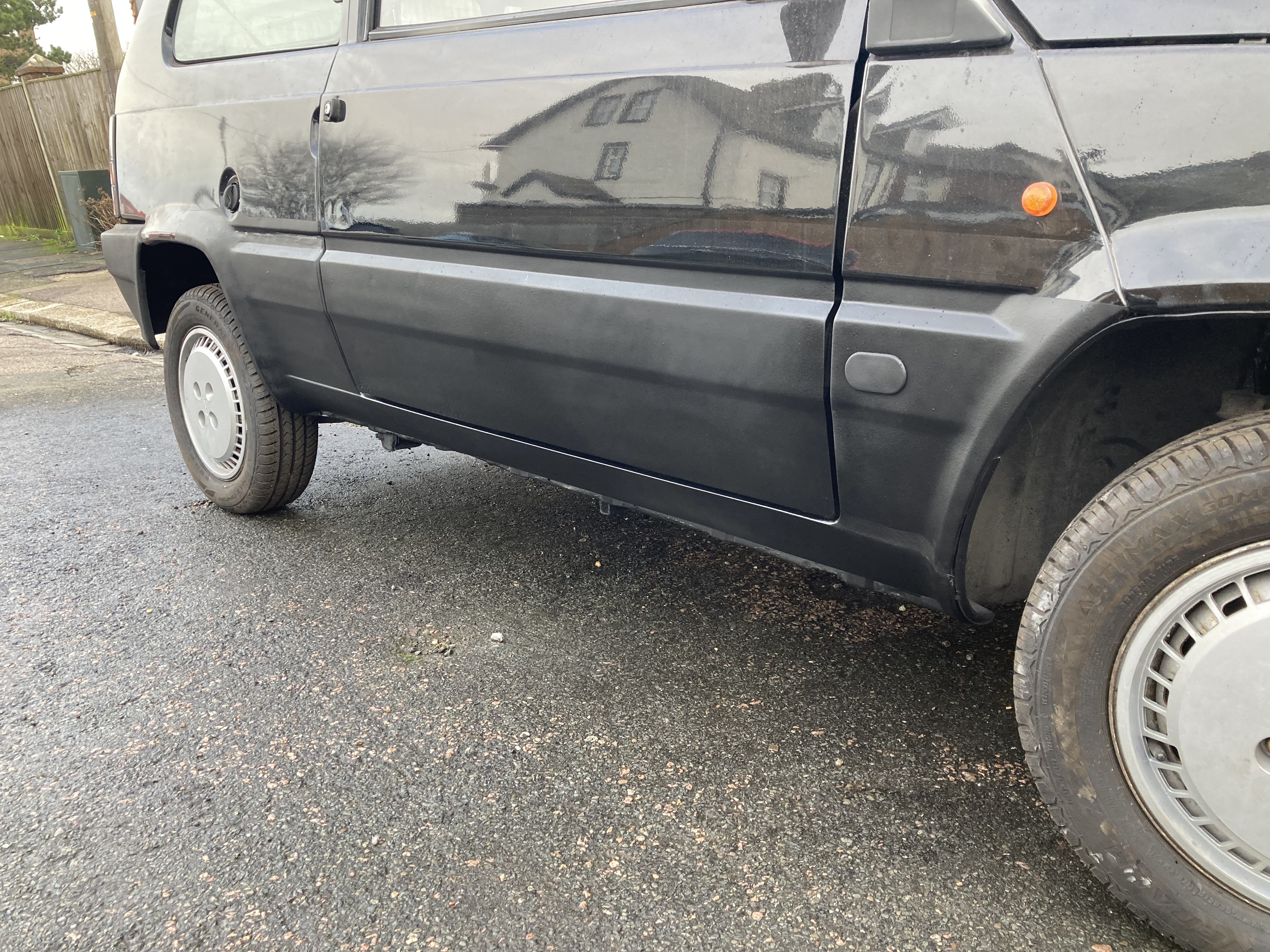

Manda is now at the point where all her rust is gone, new metal added, new sills fitted, along with new mountings for the seatbelts. Her interior is back in, fuel tank is back on and she now moves under her own steam after 16 months of being in bits (literally)
I’m looking to have her MOT’d in the next month and finally be back using her as my daily.
Now for the scary part and those of a nervous disposition may want to look away now, as I’ve added some pictures.
