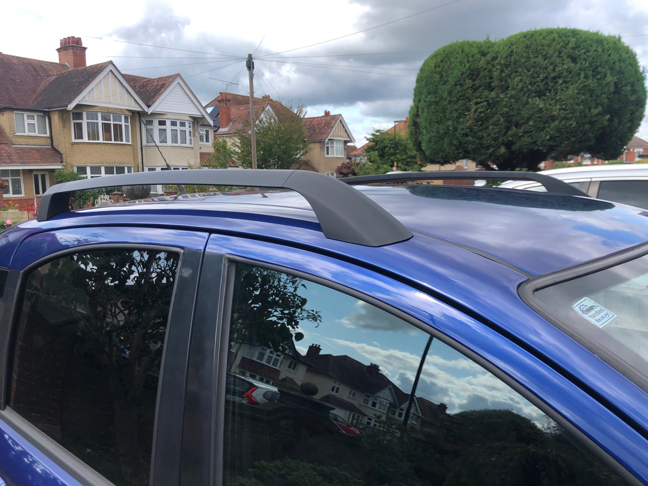

I found some locally listed on an online selling site. 1/2 hour drive to collect. Complete with the bolts washers and rubber gaskets. I’ve collected them but won’t get chance to fit until next weekend.

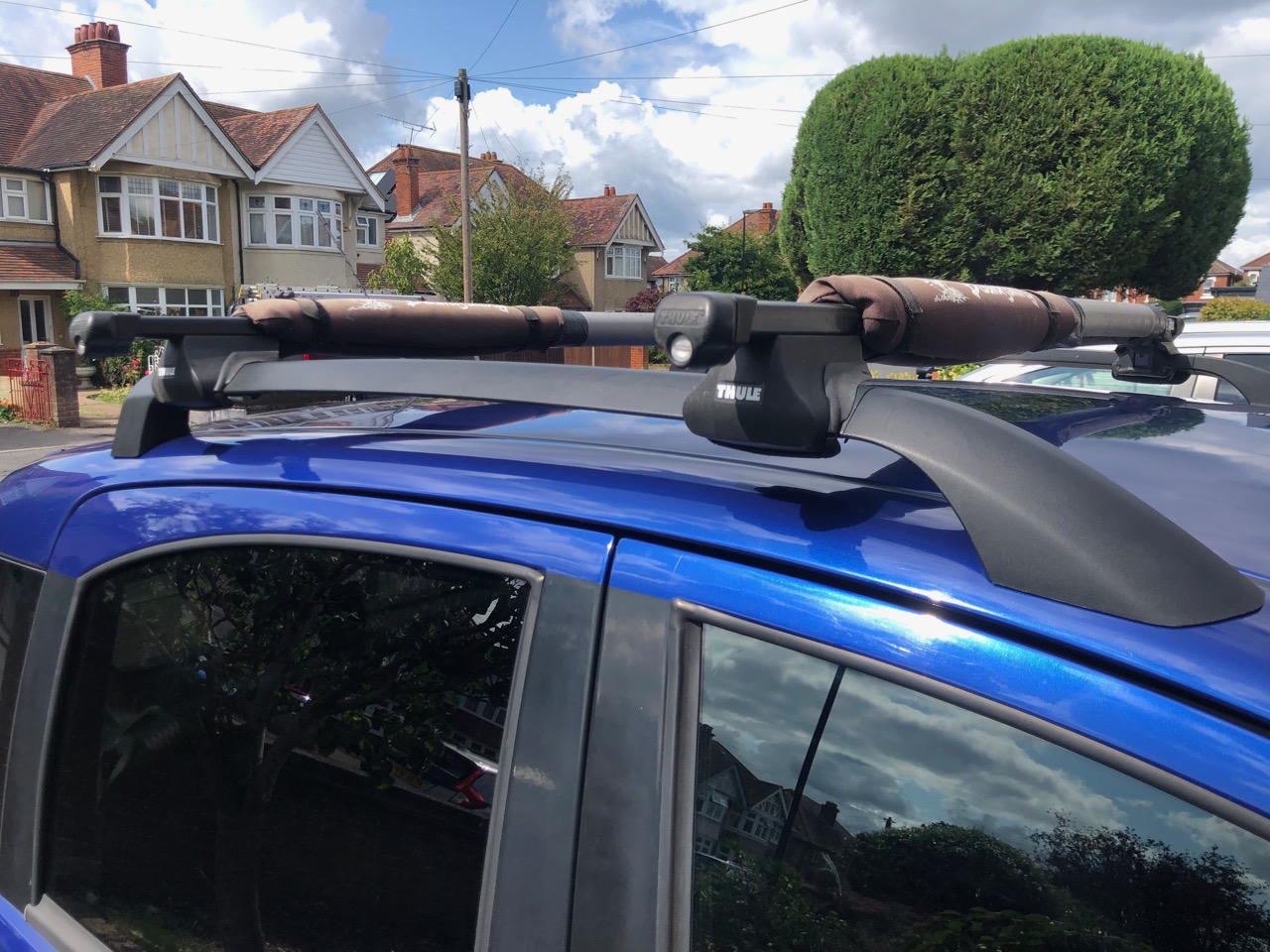

We have a couple of sets of Thule rapid fit roof bars from other cars that may be the correct length and I will need to do some research to check what fitting kit is needed.
We had a Vauxhall vectra estate and a Volvo V70 with roof rails that both used the same kit but the panda rails look a bit wider so we may need something different.
The roof rails are now fitted. It was a quick and easy job. We already had some thule roof bars in the garage that fit very well on to the panda roof rails.
