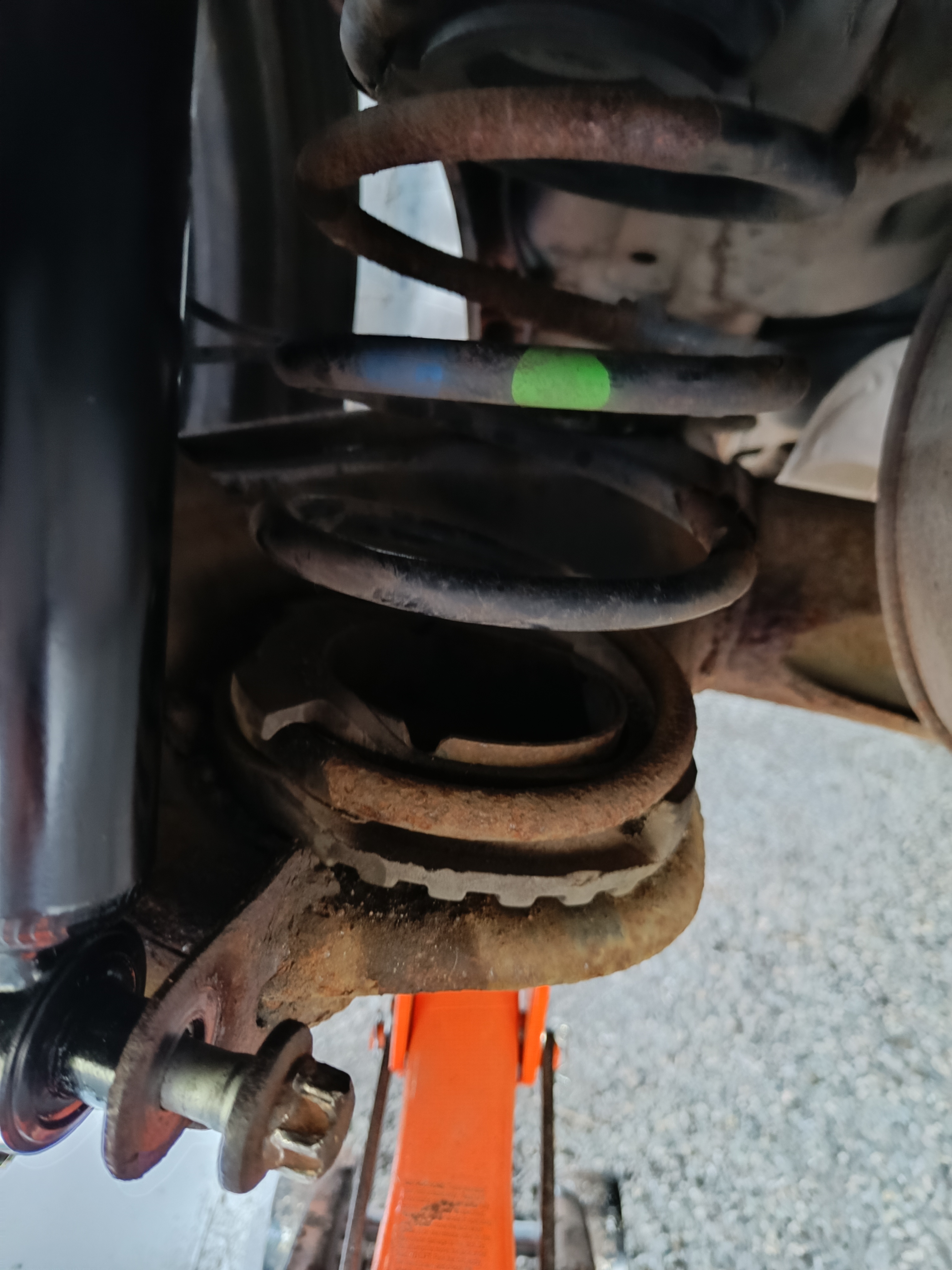

I fitted two new shocks a few days ago and upon driving it over big bumps I could notice the suspension clanging. I checked and could see one of the mounts hadn't been tightened sufficiently, its about 2mm off flush. So I've been trying to get that bolt off and having no luck. I've tried hitting the mount with a hammer and levering it, the head is getting quite close to stripped so i've stopped and I'm stuck.
I think its so tightly held that I probably wasn't hearing any movement of the mount and was instead hearing the springs bottom out. The springs are very rusted and probably don't like the new shocks. I think I could put new springs on this and that would be the end of the problem.
Possibly I could drive it over some more bumps with the other bolt loose and see if that sets the stuck one free.
What else are my options?

The bolt shown above would be a prime candidate for Vibro shocking. What you do is "shock" the end of the bolt in line with it's axis, so, basically whack it on the end with a hammer. The idea is to introduce percussive shock into the fixing which will be transferred along the axis of the bolt into the work piece and it's thread. You don't need to "whack" it into the backside of tomorrow though - you're not trying to turn it into a rivet head! What's required is a persistent firm tap, repeated over and over and over again. If there's any possibility that something like Plus Gas, P B Blaster or other "proper" releasing fluid can be persuaded to creep in then it can often help. The technique is to tap away for a while and then try a spanner/socket/whatever on it and see whether, with reasonable force applied, you can unscrew the fixing. If you are needing to apply enough force that there's danger of the bolt snapping then stop and do some more tapping. keep on doing this until the bolt unscrews or you run out of patience.
I'm not sure what you are trying to show us here. Looks like the bolt is loosened? Is it refusing to tighten?
Regarding the Vibro Shocking technique. I was shown this many years ago by one of the older men in the workshop and was very sceptical about it working but, by golly, it often does. Of course there are some beyond helping and will snap off unless something like an oxy-acetylene torch is available but I've had great success with it. If you have access to an air compressor and air hammer then that works very well with a flat faced punch. I like this technique so much that some years ago I bought an actual Vibroshock socket set:
I've had particular success with seized brake bleed nipples, in fact I've not snapped one since! Only trouble is you do need a reasonably "meaty" compressor and air hammer because sometimes you need to let it hammer on for quite a while. The "secret to success" is to let the vibrations loosen the fixing and not to try forcing it with the wrench handle too soon. Once the vibrations have done their work the wrench handle can be turned with just average force. If it's needing to be forced then you're still likely to snap the fixing. Just let it rattle on until it slackens with only moderate force applied. Same applies to the tapping with a hammer. It's not the force used, in fact don't hit it too hard, all you'll end up doing is mushrooming it. Realize it's the vibration of the tapping which disturbs the corrosion and allows the fixing to be slackened.
I added that picture to show the springs, i'm not really sure how much performance these rusty things have lost, but its probably a lot. I suppose I'm wondering at what point do springs need to be replaced?

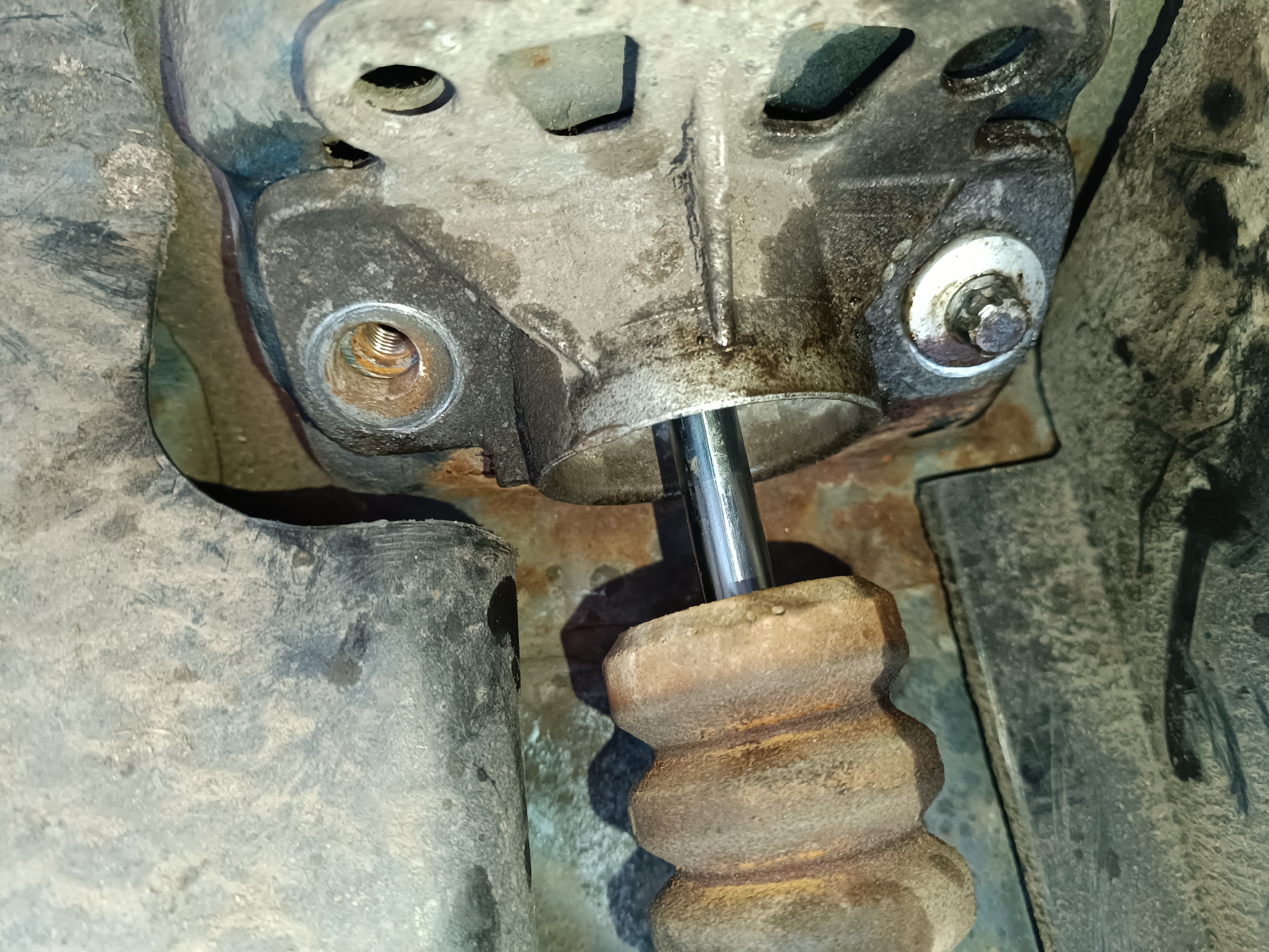

I managed to get some time on it a while ago but can't shift the bolt with tapping or hammering. I tried the techniques you suggested although the inclement weather has meant I haven't spent as long on it as I'd have liked. i.e. it started raining again :D
Next thing is to buy some better spray. I have looked at PlusGas but can't get it sent quickly. I have however found some WD40 penetrant. It isn't the same as the multi-use WD40 I currently have. At a guess it'll be a copy of PlusGas so maybe i'll try that? It'd arrive tomorrow so I can have another go at this bolt on Friday morning.
