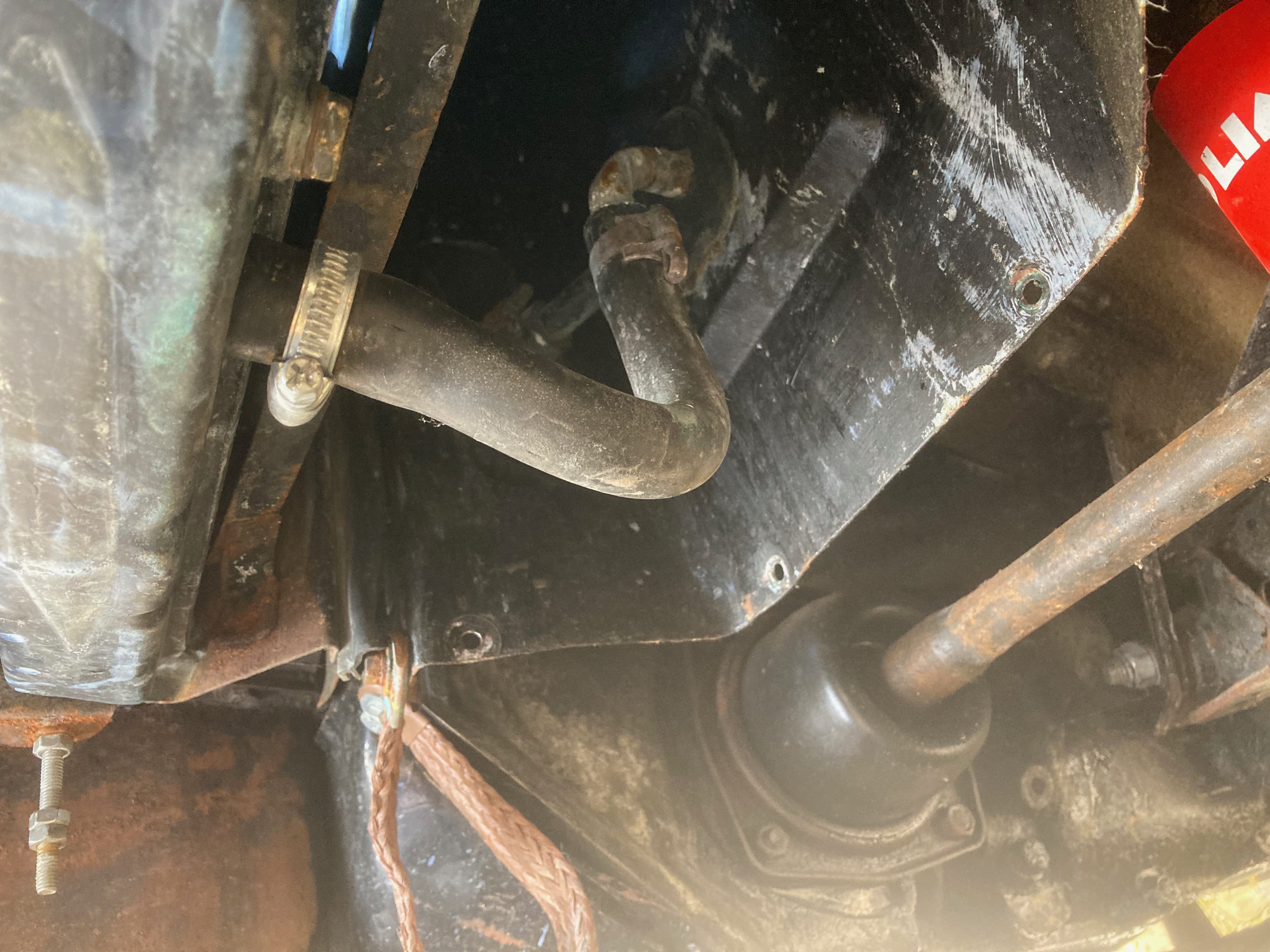

Hi
Sorry for the delay.
I've attached a couple of photo's looking up underneath my 900T with the bottom reverse scoop removed.
The panel between the radiator and body work is welded in place (from the factory) and is designed to stop air pushing through the rad when travelling forward.
The fan pushes air through the rad (against the forward motion) and out through the gap between the rad and panel. The bottom cowl then directs the hot air back under the engine bay - hence the need for the engine bay floor plates to reduce the amount of hot air coming back into the engine bay. That's where I've added the extra ducting to make sure hot air goes beyond the engine bay,
Not the greatest design from Fiat (but it was the 1970's)... it would have been much better if they had stuck the rad behind the engine cover and let the air flow naturally out the back rather than forcing a U-turn on the airflow.
Hope this helps.

Hi, Gary50 thanks for the pictures.
The panel on mine is not in those pictures, so the mystery continues

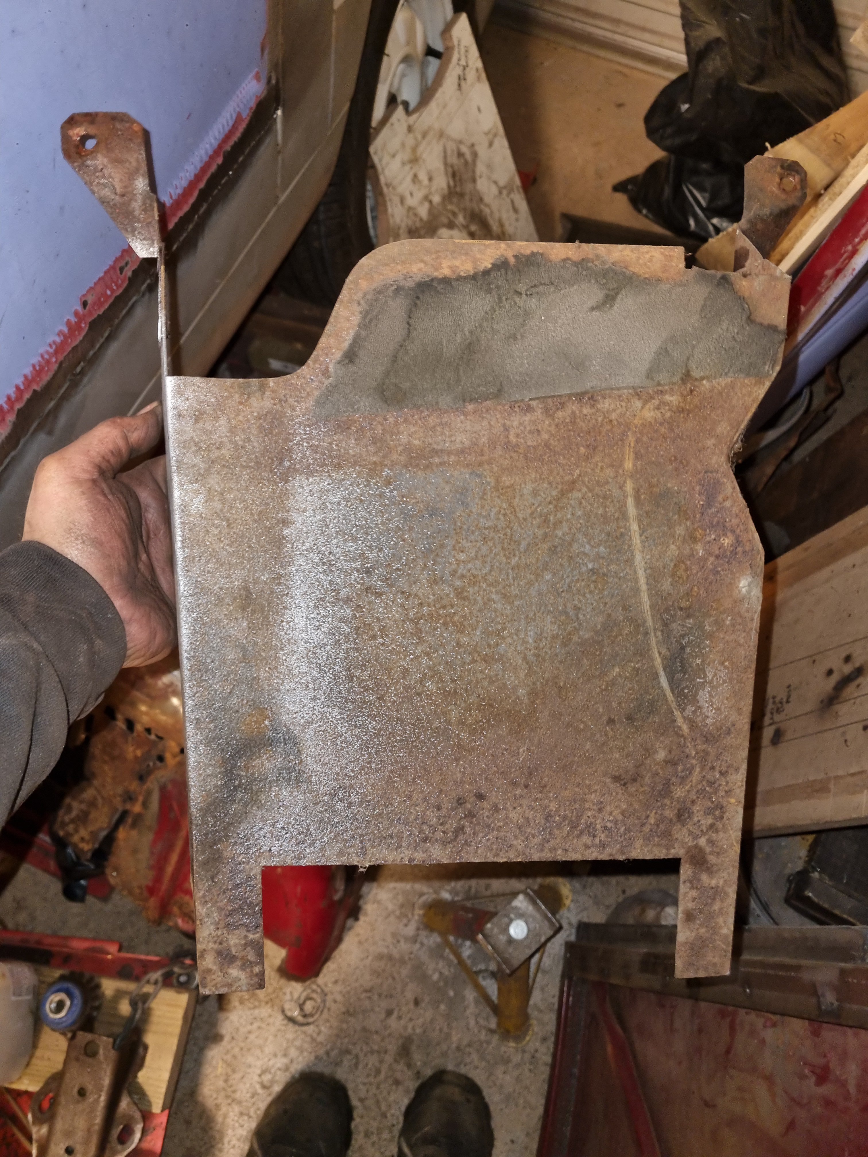

So a full year on and I've finally got to take this panel and radiator out ready for the engine coming out this week
This is the part in question.
It's definitely a factory panel and as far as I can tell it seems to shroud the heater pipes and prevent the fan from blasting air through the channel the pipes pass through.
It's possible that it could create a pressure difference creating some kind of venturi effect but
A, thats way over my head
B, I'd be surprised if fiat put that much effort into a cooling system that seems marginal at best
Deffo looks 'factory' but got me intrigued!
It's a factory fit alright, it even bolts to captive studs on the bulk head.
