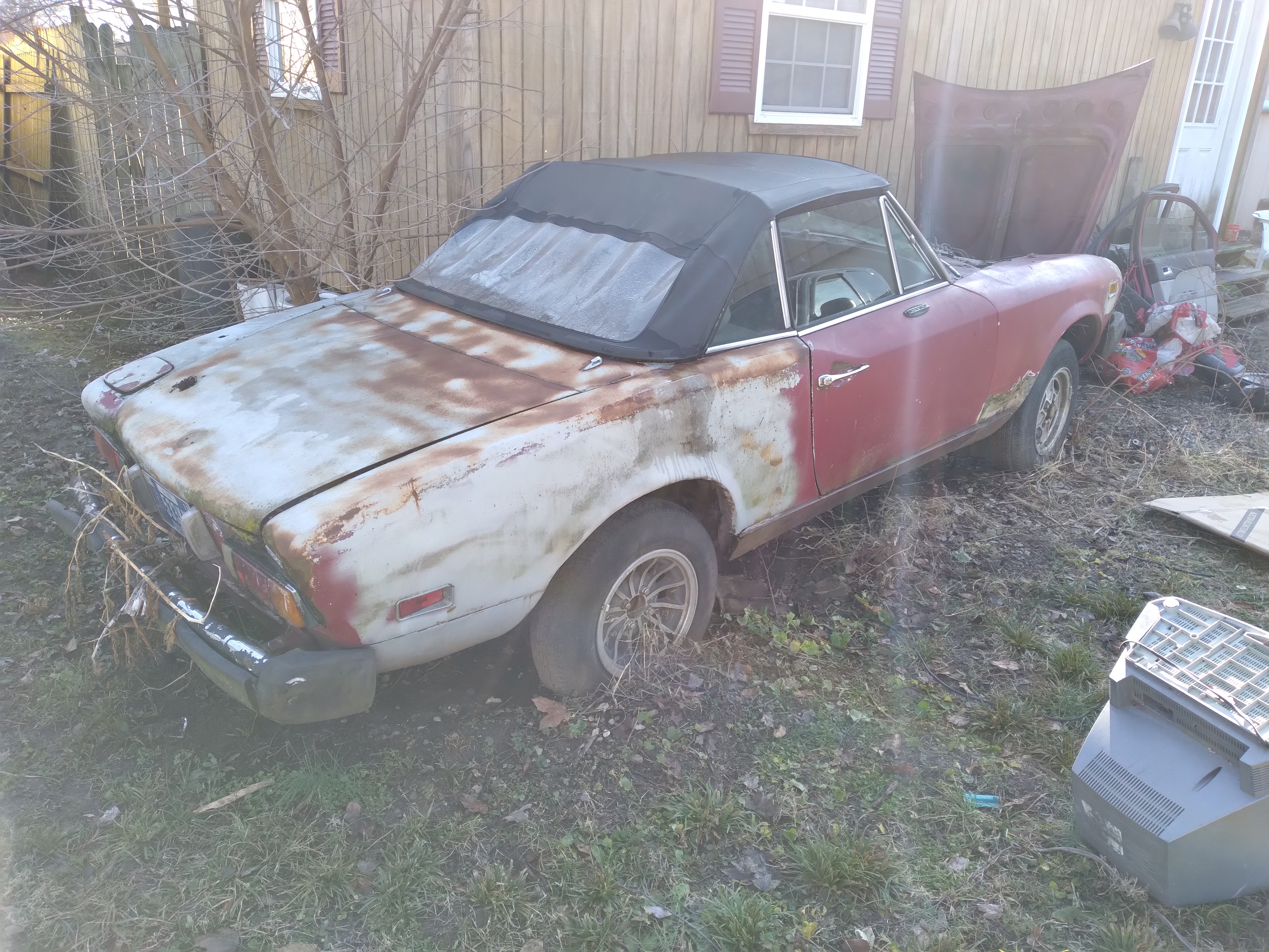

I talked to a fellow today who wants to trade his Spider for my old beater car. Mine runs and his doesn't. I first mentioned it as a 1967 model as that's what he said it was. When I took pictures, I took one of the registration so I'd have the VIN. It turns out it's a 1977 model. Regardless, I'd like to ask the cognoscenti here for advice. I was trained as a mechanic back in the 1970's and have kept my hand in since so I'm quite able to handle repairs.
Anyway, the car is right on the cusp between a project and a parts car. I hesitate to break any car up unless it's just beyond repair. This one though, mechanically, the current owner said he pulled the transmission and repaired it as it was missing a gear. Clutch at the same time. He also redid the rear end as well as going through the front end. 2 or 3 years ago,he was driving down the road and it started puking oil out the back. He then parked it and it's been in his back yard ever since.I thought a hole burned into a piston head but there isn't any oil up top. He never pulled the engine to see what the problem was. He thinks it may have thrown a rod through the oil pan. Usually that will make a noise, but maybe not. I'm thinking it may be that or something simple like an oil cooler failing or even a oil drain plug falling out. I grabbed the timing belt and lower cran pulley and the engine rotated by hand. I could feel compression as it turned. This was by hand and not a socket. Mechanically, it's definitely worth saving.
The body. It's rough. I've seen worse, but it is definitely a project. The top is newer but may need attention. The body is fairly straight. Underneath I expected rust but it's not as bad as I expected. There is rust though. Definitely needing floor pans. Interior is filthy but decent. The seats aren't split. It looks complete. The dog house has some thumps as well as poor rust repair in the past. Mismatched wheels.
Overall, it's an ambitious restoration. My plan if I get it is to get it running and driving and then move it along to someone who is better at body work than I am. Attached are photos of it when I looked at it. Keep in mind pictures often make cars look better than they really are. Any advice or opinions are welcome.
