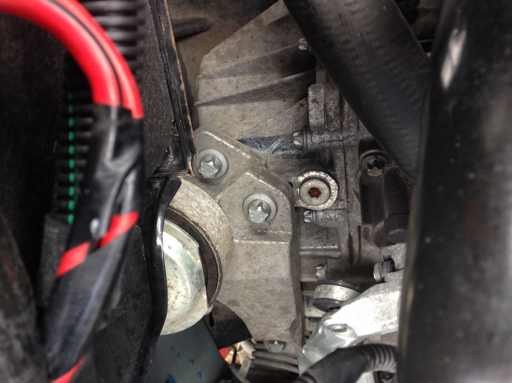

Photo 1 shows the refill point between the hoses and the battery. I just used a channelled bit of plastic to let the oil run into it - this meant I didn't have to remove any engine bay components.

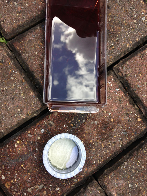

Photo 2 shows the difference in colour between the outgoing redish looking oil and the fresh yellow oil.

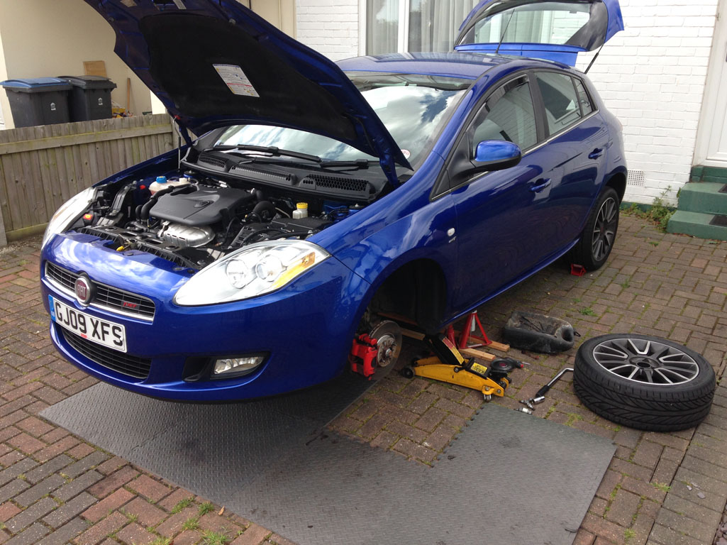

Photo 4 shows the setup. My drive is on a slight slope so with it being jacked up at the front, it almost made it level for draining.

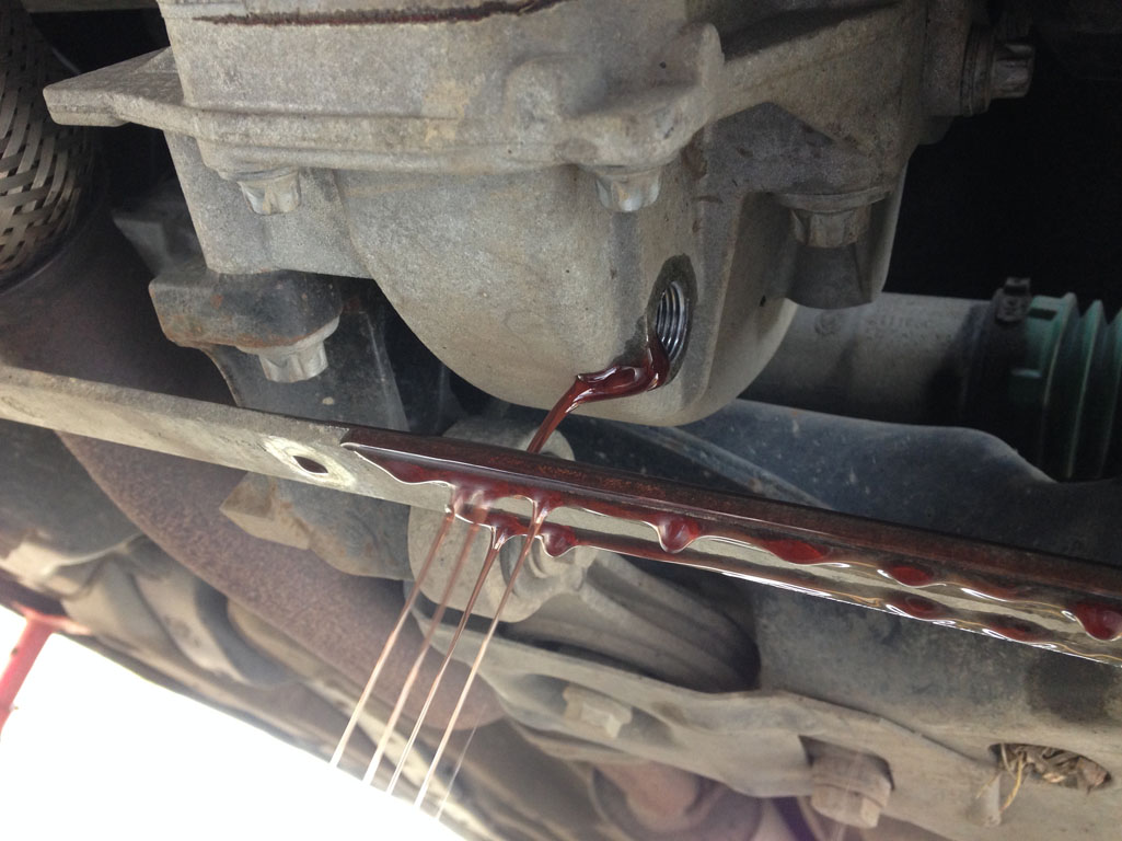

Photo 5 indicates where the drain plug is.
Photo 6 shows another view of the refill point.

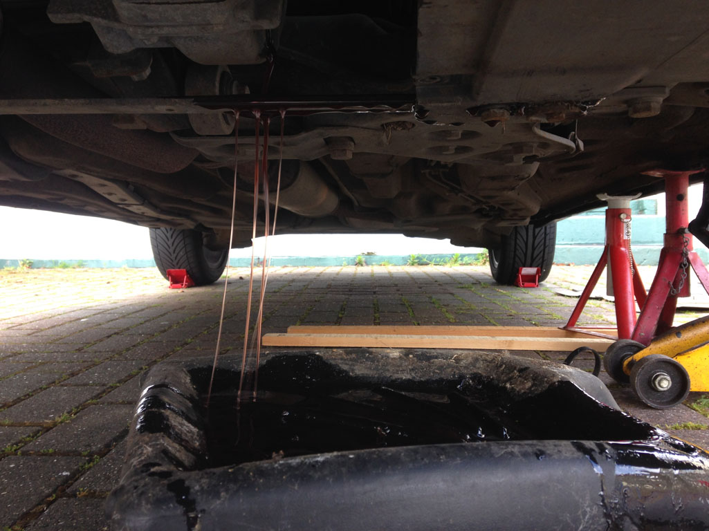

Photo 7 and 8 shows the mess it makes! There's a metal beam underneath which it just drips straight onto so it just runs everywhere off that!
