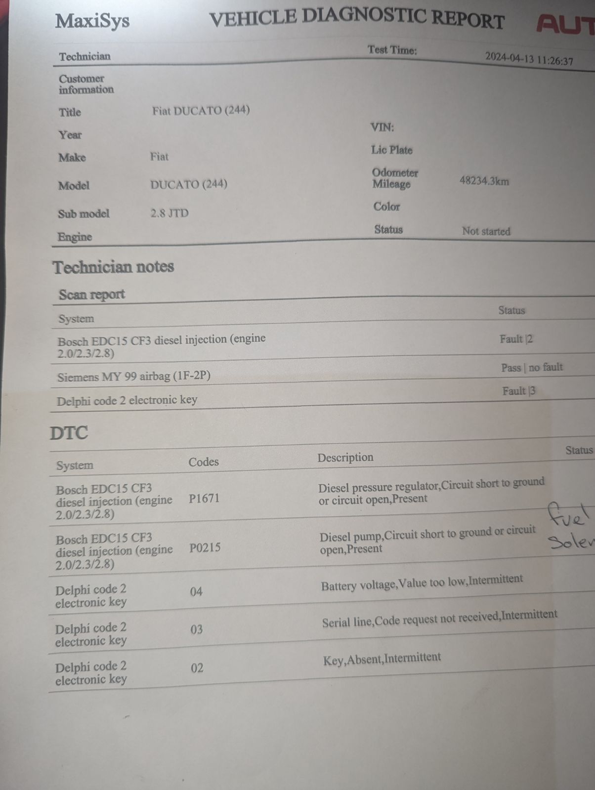

fault codes p1671 and p0215 show up on odbc scanner

It's been 3 months now and everybody who comes and plugs it into a tablet or laptop via the odb port is left scratching there head then goes away assuring me they will be back after doing some more research and there never seen again.

The code P1671 is manufacturer specific, but may be suggesting a fuel pressure regulator fault, however if there is no fuel to the hp pump, then there will be no pressure to regulate, or is the ECU seeing the regulator as disconnected?
Code P0215 is commonly allocated to "fuel cutoff solenoid", which does not exist in the 2.8jtd. I have found mention after an online search of P0215 relating to the main injection relay. This would make more sense as relay T09, is the main injection relay. If not being operated by the ECU, engine will not start.
Both of these codes could be symptoms of faulty wiring.

I think the p1671 code relates to the solenoid regulation valve on the high pressure pump or it's wiring.
If the regulation solenoid valve is not working no fuel will enter the high pressure pump .

I have been researching Fiat eLearn, for 2.8jtd, and where better written that for the 2.0jtd, both of which use the Bosch EDC 15C7 ECU.
The ECU has to have several conditions satisfied, before injection is allowed. One condition is that fuel pressure is greater than 120 Bar, another is that the hp pressure regulator must be "seen" by the ECU. (The ECU shuts down if electric regulator valve is not detected.)
Without a supply to the hp regulator valve the hp pump output is restricted to 100 Bar.
Relay T9 is described as the main injection relay, so starting cannot take place until it is operated. It is not clear to me whether the ECU inhibits injection via T9, or more directly by internal connections, but either way we need T9, and the hp regulator to be seen by the ECU.
I could have arrived at an incorrect conclusion. Helpful comments are welcome.
