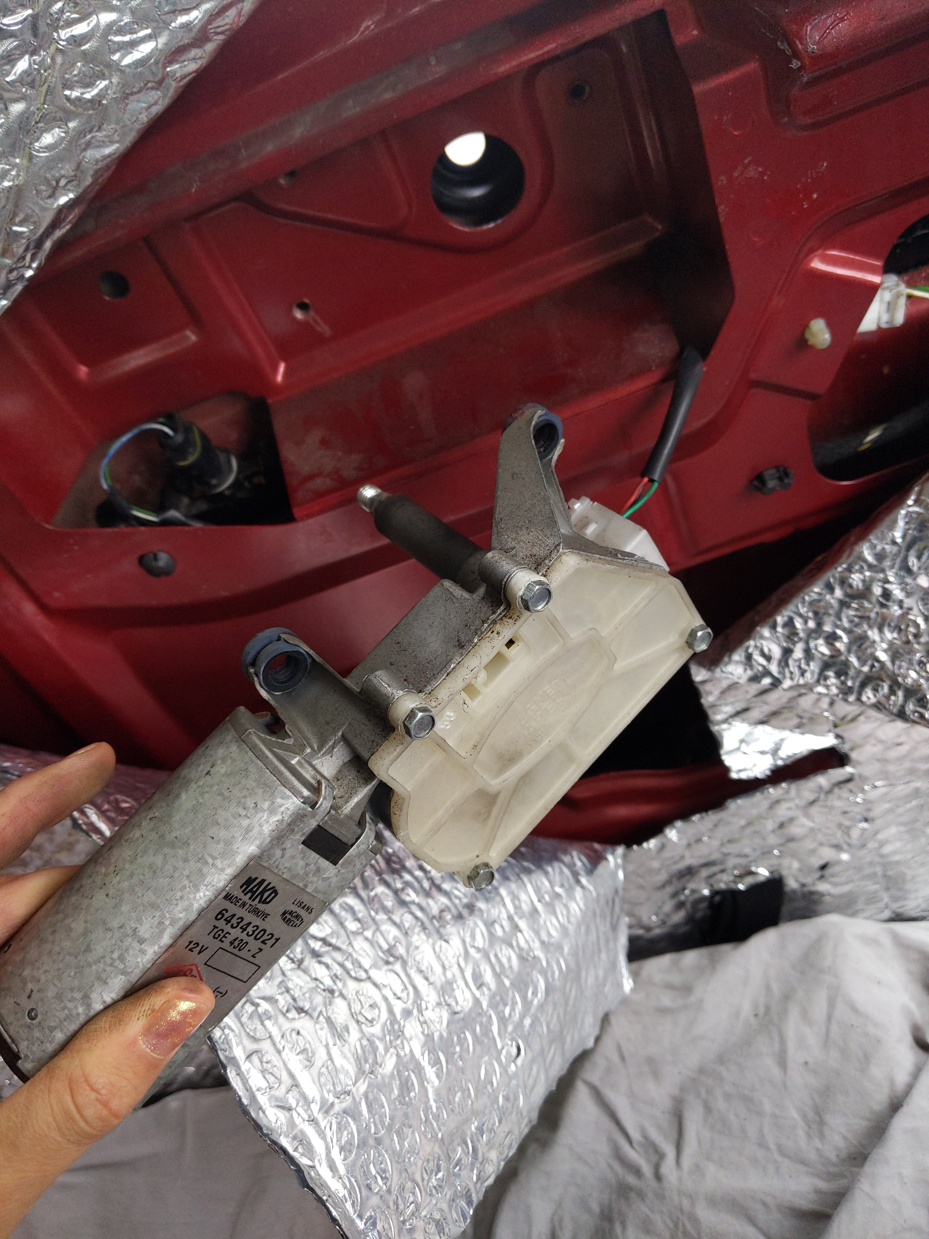

The rear wiper has never worked but I need to fix it for MOT. A new fused tried but that didn't work, I am aware it could either be a relay or the motor that has gone.
I've removed the plastic trim but I have no idea what I'm looking at / what are indicators of something needing replacement. If anyone knows please help! Also will replacement involve any rewiring and electrical tools? I have basic car tools and want to give it a crack to save some money.

Thanks, a guide would be super useful, I have take the wider arm off and unbolted the motor, I'm just unsure how to detach the cables / electrical side of things. I have found another motor at a scrapyard so will try and replace.
The three cable runs into a circuit board, I was hoping I would be able to change the motor without having to solder in a new circuit, as I don't have any of those tools. Would that be the case though with this set up?
Thanks, a guide would be super useful, I have take the wider arm off and unbolted the motor, I'm just unsure how to detach the cables / electrical side of things. I have found another motor at a scrapyard so will try and replace. View attachment 405698View attachment 405699
Bingo. Didn't realize the clip was hiding behind done metal. Hopefully a replacement will fix ussue

on mine just the shaft rusted in the guide tube. the motor was still working. First time i managed to to get that lose but a year later it was stuck again so that i built in a second hand part off the scrapyard.
