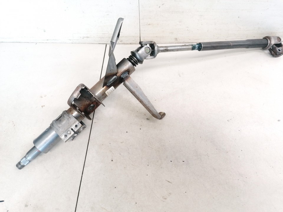

Have been reading several days all the topics about the faulty powersteering on my panda.
Never had a car with power steering before and yesterday had the change to drive a Panda 169 without powersteering original and it wasnt steering that heavy.
Now am i looking for whitch parts a need te converse my Panda with powersteering to a panda without.
Tha car is a LHD so the parts must be avialble if if am reading well. Here in the Netherlands there is no MOT rules that says that i cant convert it to mechinal steering so that is not a part of the problem.
Is it enough to replace to steeringkolom to a steeringkolom without the electri motor or is the steering rack also different?
Also would i like to ask if this is the right kolom (picture) for a car without powersteerieng.

The rack is different
You will also have to reprogram the body computer, to remove the warning light
As far as I can tell the inter connecting shaft is the same

Thank you both for the reply, and the offered information, the drawing of the parts are very helpfull,
so on my partslist goes for know:
- one steeringkolom
- one steeringrack (have seen that these new are quite affordable
- programming to reset the steeringfaullight (thats one thing i need to look in further to)

I can not be 100% sure as nobody as far as I know nobody has done it
Steering wheel, hubs everything else mentioned so far are identical regardless of EPS or not as far as I can check
I suspect you could just need to buy the rack
removing the motor from the column disconect it's electronics
And do a proxi in multiECUscan
Disconnecting modules and running a proxi has removed the ABS on a punto
But there's no garentee it will work on the Esp and the Panda
