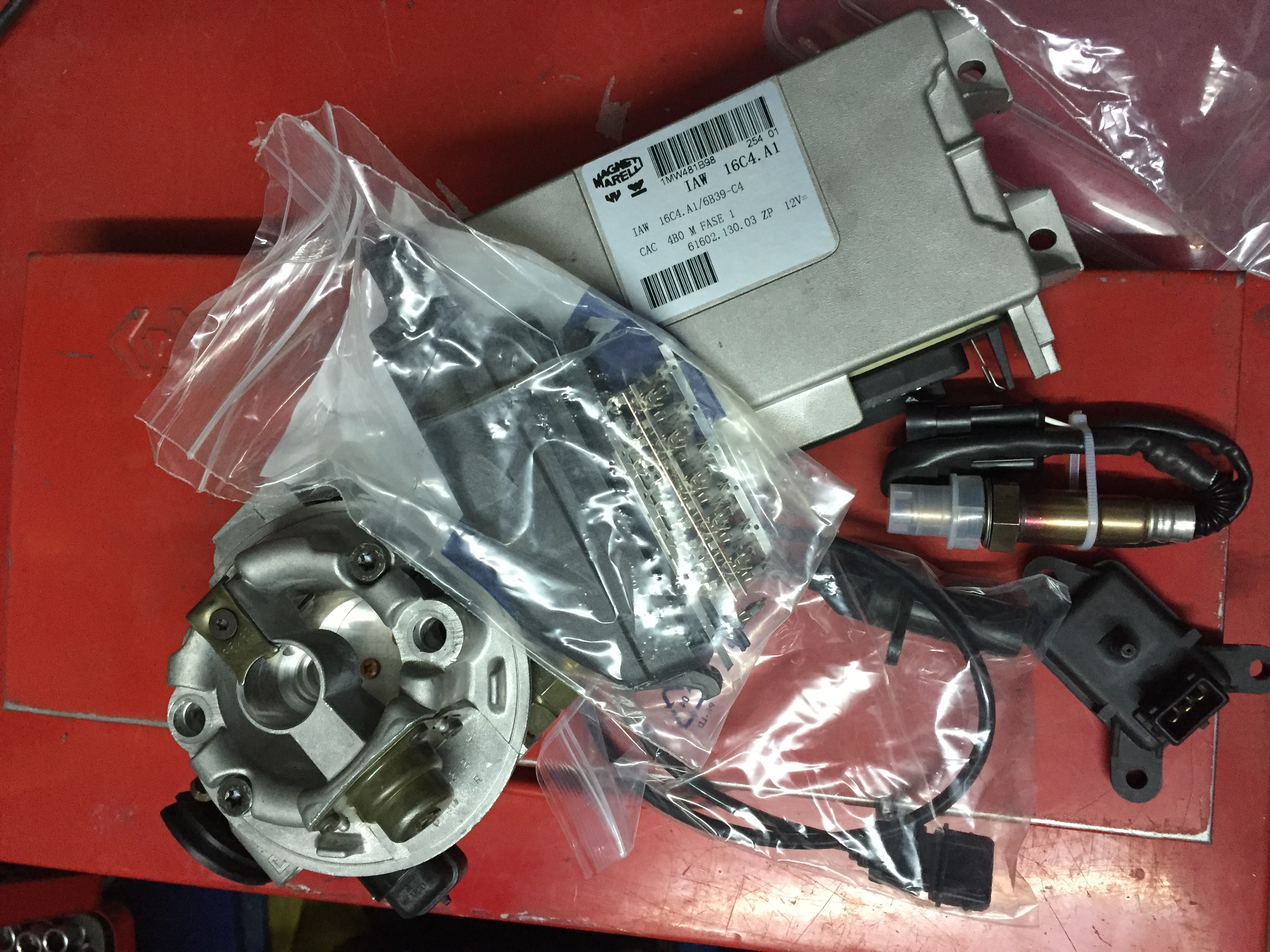

I got a magnitti marrilli IAW 16F C4 ECU with harness do you think it will match the car ? Meanwhile , if I want to remap the ECU ,do you have any idea what chip they are using and tuning software ? B/c as per my research I might need to add some fuel as it might run lean .

I have figure out all and started to build the harness but is the power latch relay important ?
Help plssssss
No I got the ECU in a very good price while I also got the xdf file to tune it with tunerpro but on the factory installation they use power latch relay which energizes while the engine is off , should I use that or by pass it ?
