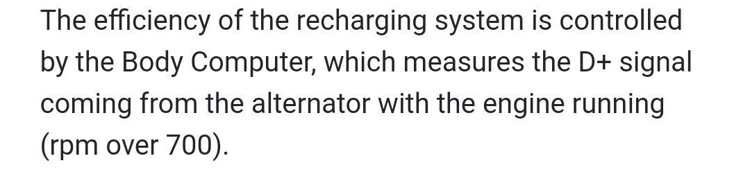

Found this:-
The voltage is totally controlled and set by the CPU. Advanced protocols use a PWM (pulse width modulation) type encoding. The pulse width of the signal sent by the CPU to the alternator determines the voltage regulation. Essentially, it’s still a one-way communication flow.
The alternator and internal voltage regulator are connected to battery positive through a 100-amp fuse located in the underhood fuse box. The ECM controls charging voltage via a square-wave signal sent through a Local Interconnect Network (LIN) communications wire to the voltage regulator.
