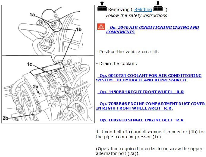

Hi Navin,
first I guess you posted this on the Grande section since the Linea is very similar to it, right ?
If so and have A/C, be aware that you'll have to empty it (disconnect pipe) in order to access one of the alternator bolts… and maybe the driver's side shaft if you need to catch the alternator from below (not sure tho).

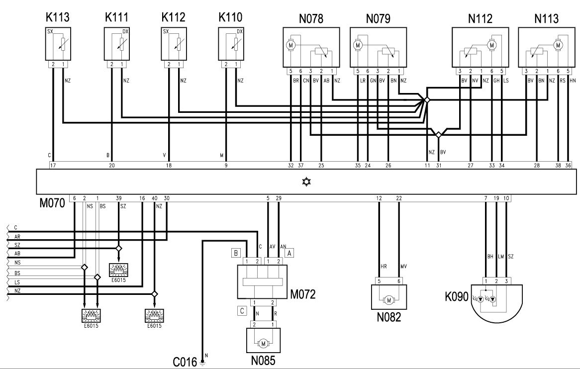

It seems pretty obvious that water is the main cause of those malfunctions ! Automatic A/C doesn't use the typical resistor plug configuration as fan speed selector but an electronic module (M072 on the drawing) instead so it might haven't been enough just to let it dry …
As a general rule, you should open every electrical connection and check for moisture/corrosion and cure it if found any.

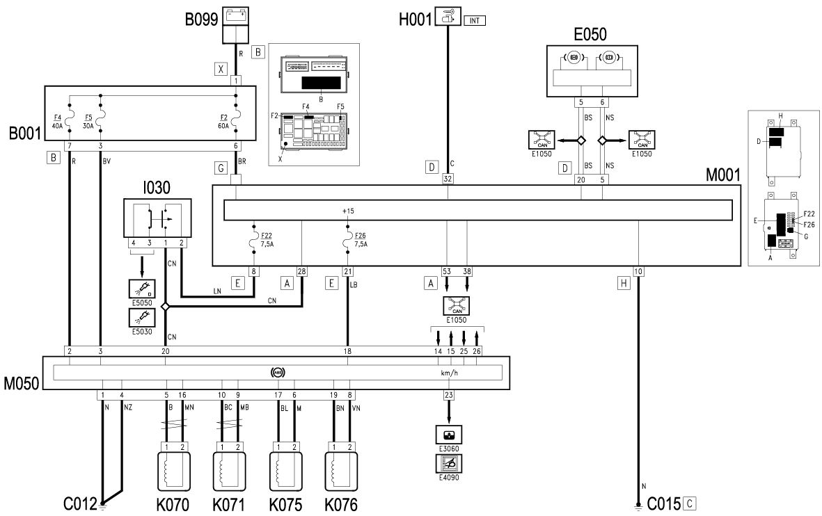

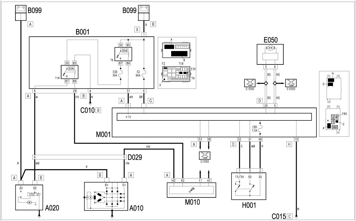

Here are some Drawings, they're from GPs so don't blame me if they Don't match your car's …
BRs, Bernie

Not sure, have a look at the drawing if your engine looks like this I'm afraid you'll have to drain the A/C …
BRs, Bernie

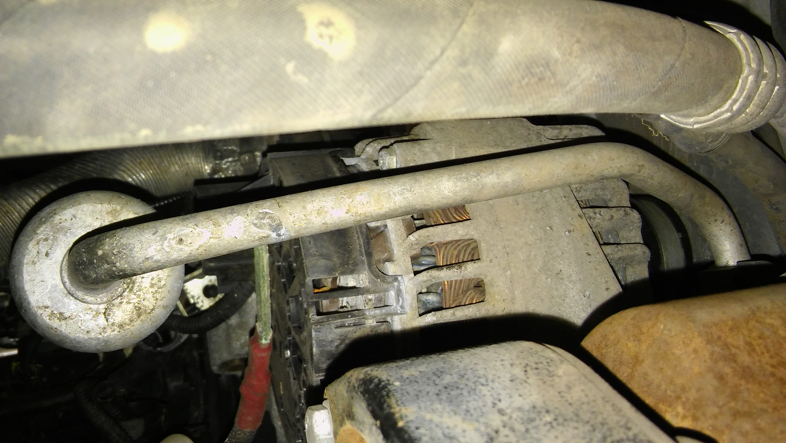

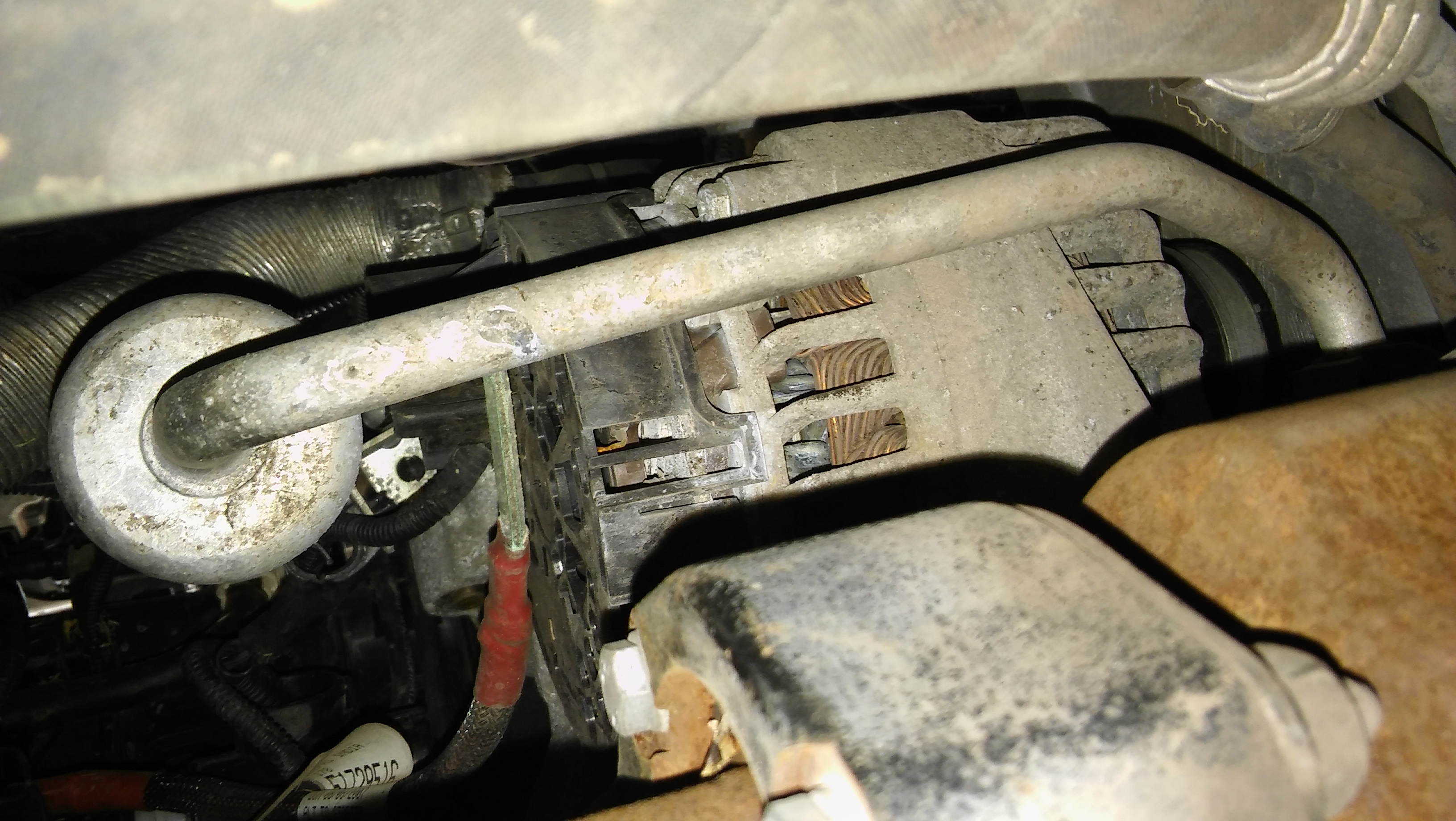

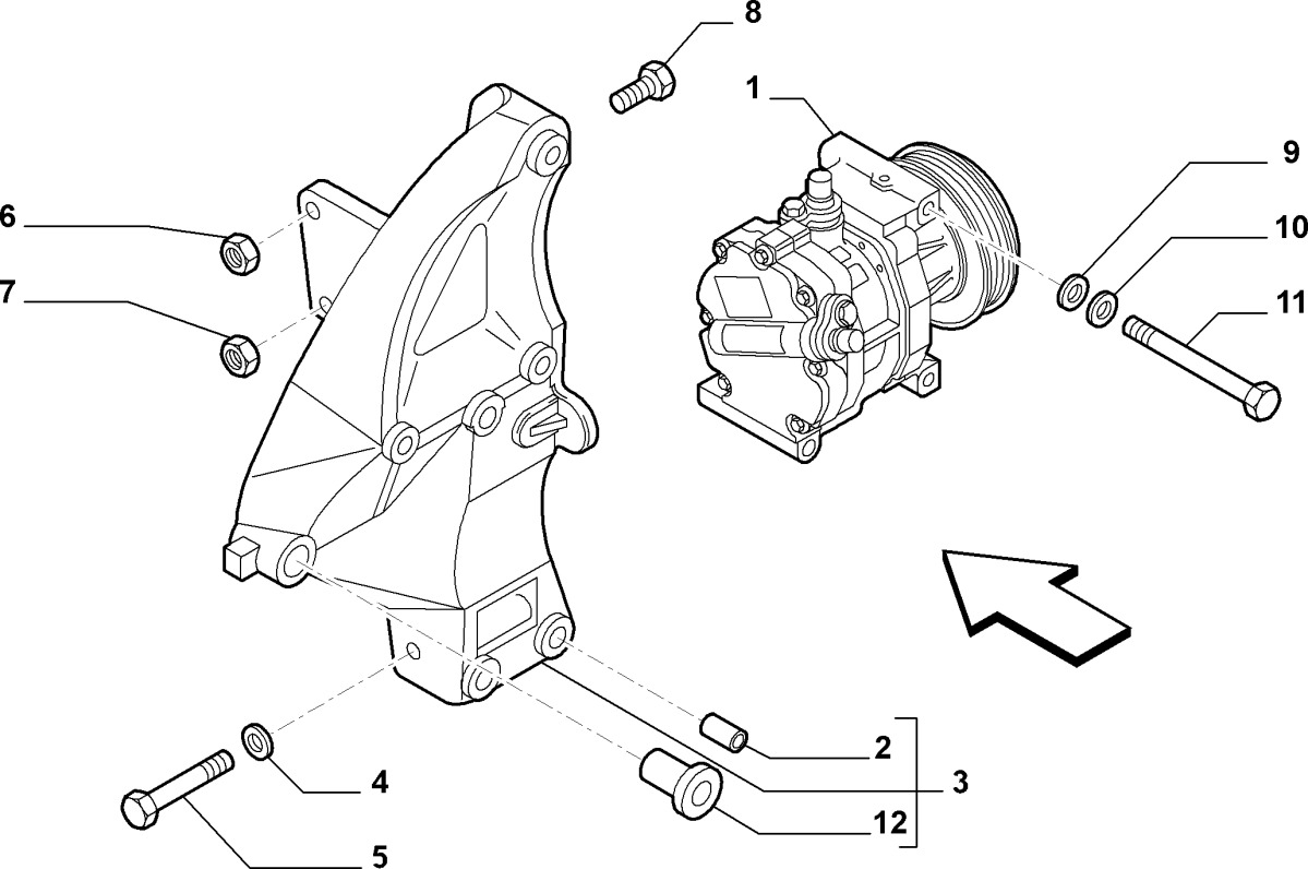

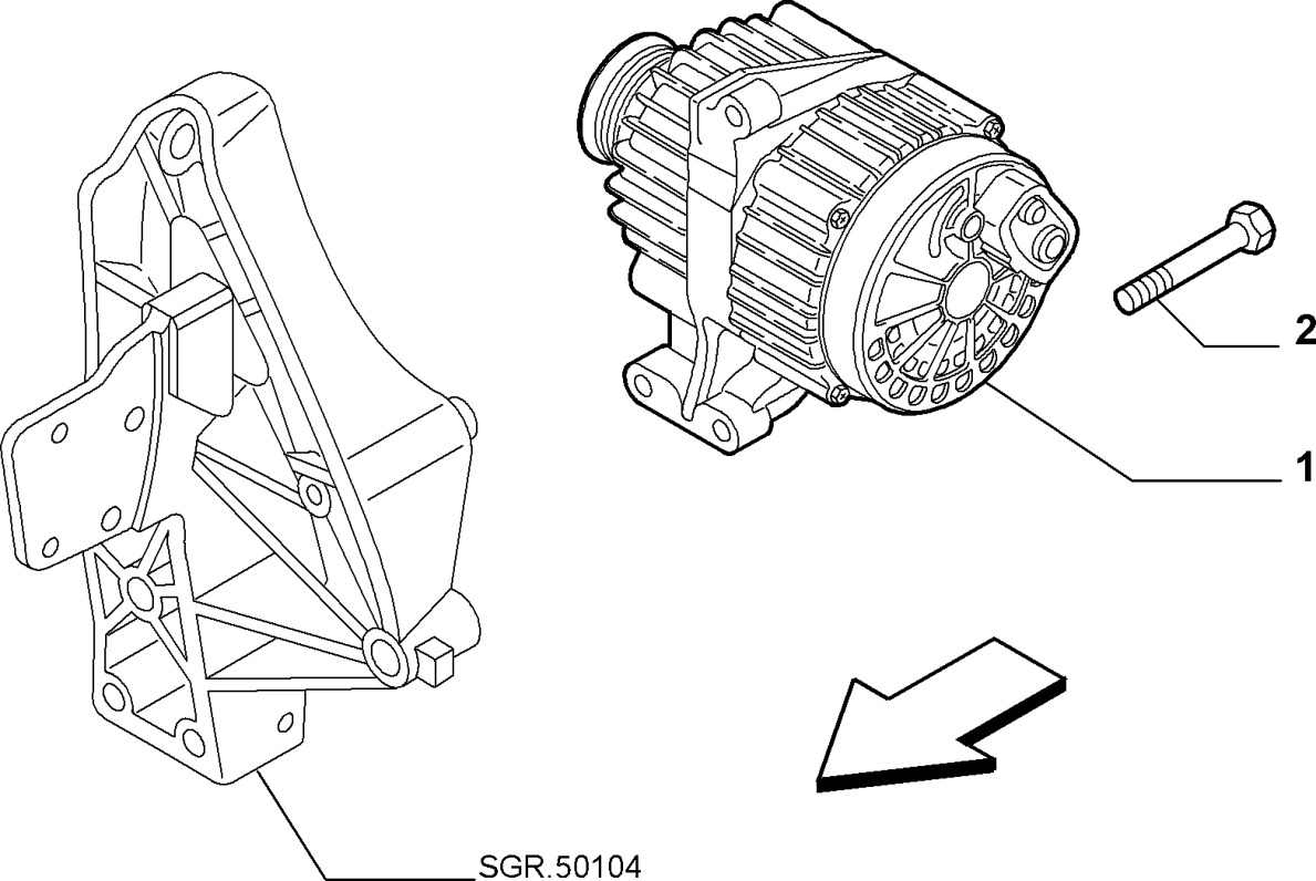

Let me add some images/pictures for further visual ideas to the viewing people:

Hi Navin,
the starter "puller" is activated by a relay in the connection box (engine bay) and is fuse protected; I'd have a look at those before further investigation …
BRs, Bernie
If someone here helped You fix -or better, understand- your issue, hit the thanks icon @ bottom right corner, it's free and makes us feel helpy ;-)

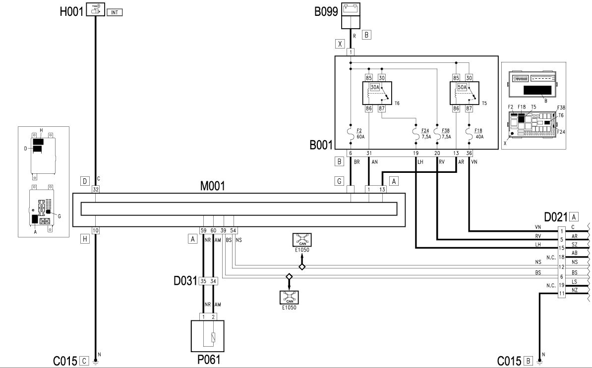

Sir,
The circuit in #9 is different and the Fuses and Relays are not matching with that of mine. Here I am attaching a circuit which is matching with that of my Linea.
I have checked all fuses and relays on the engine bay - every thing is ok.
I have also checked continuity of the battery wires to earth on gearbox, connected to alternator and starter motor. etc.
key on MAR gives power to all other devices to function.
Could this starting problem may happen due to the tilted position of the car? (as it is front side is still supported on stand-jacks keeping both the front wheels up)
May there be any sensor which may cause this problem?
