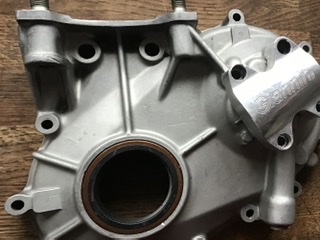

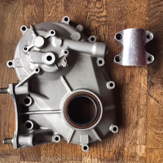

I did not have my thinking cap on yesterday because I realised I had a brand new modified timing chain cover and oil outlet adaptor in my spare parts.

The adaptor fixes into the same M6 holes that locate the oil pump on the inside of the timing chain cover. They are drilled and tapped all the way through. There is a hole drilled through to the centre of the oil pump, the outside of the cover is machined with flats to position the adaptor.
