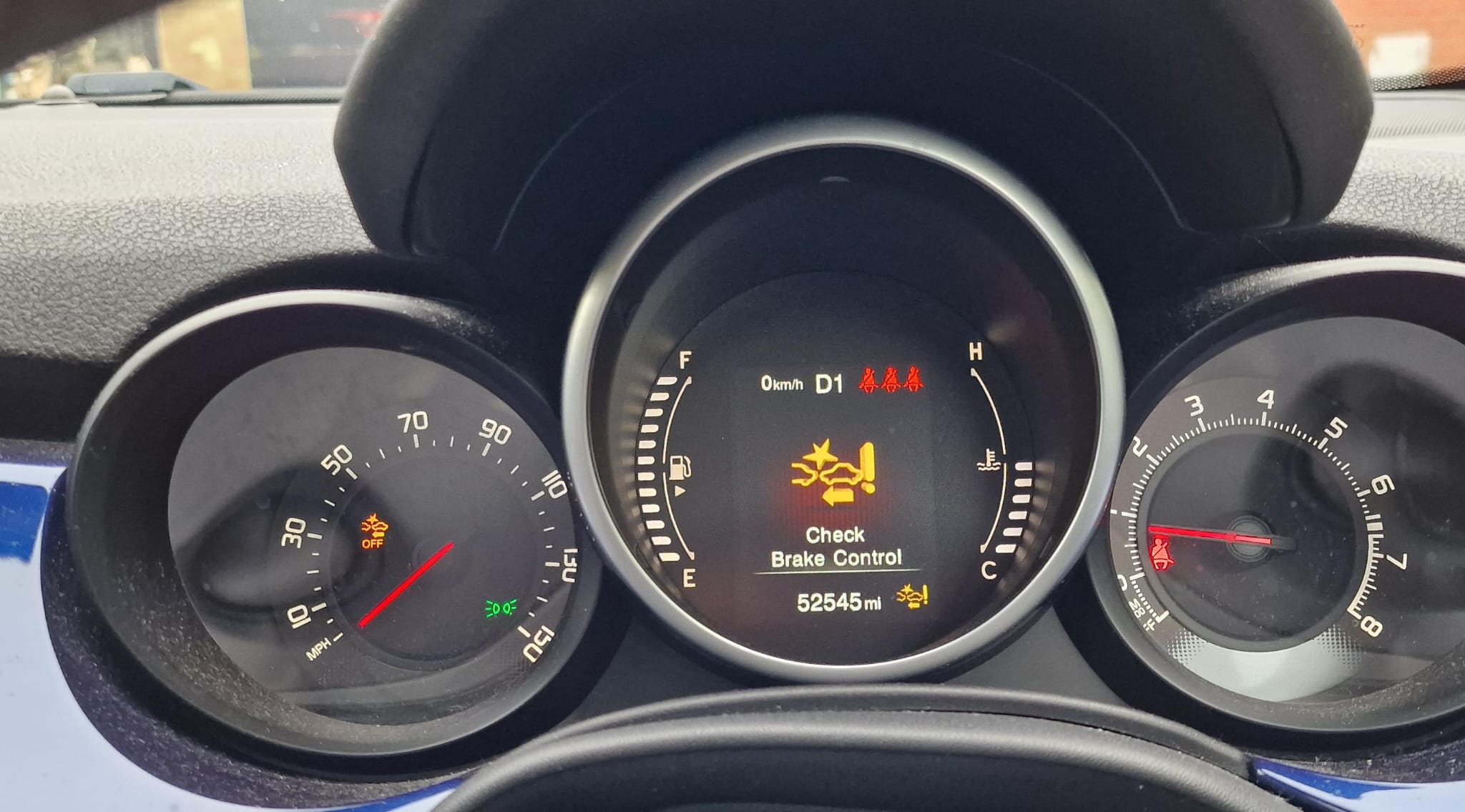

Hi Guys,
I have a 500x Lounge 2016 and get the 'Check Brake Control' warning as seen on the pic. It does go off after a while but then the small warning on the left of the pic says 'Brake Control Off'. It drives perfectly well and then that centre light flashes on again and usually stays on for a few mins. Problem is the car now needs an MOT and I dont think they will pass it like that.
I believe it is something to do with the lane sensors. Perhaps one is broken or something but I have no idea where they are or how to check them.
Anyone had similar problems?
PS I had to replace one fog light which was pushed back (from the front it seemed OK but when I got to the back of it, it was broken and the bulb had completely burned out and melted some of the housing) so it looks like it may have had a knock at some point. However there does not seem to be any other damage.

Hi Guys,

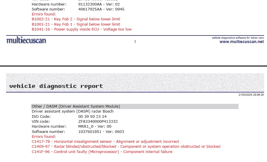

I am adding part of the diagnostics report which I believe may be connected to this. I will post it in another thread if no one replies here.
Thanks any help or comments appreciated

OK .... here we go. Not sure if I have fixed it or not. First thing I did was play areound with the in-car menus etc which go into car setup and driver assist menus etc. I did that and turned the lane assist on and off a few times with stopping and starting a fewtimes. It seemed to succeed.
I booked the car in for an MOT and the night before I was driving (obviously on my way to the MOT ;-) and I was playing testing the lane assist to see if the car could 'drive itself' ...... it cant! The lane adjustment is a little too severe and sends you heading to the other lane line which sends you back again but at too much of an angle. So dont fall asleep depending on this lane assist. My guess is you would eventually end up on the roof ......
Sorry I digress. After all that playing I proceded normally and .... yep the Check Brake Control light came back on and the small light indicating that that system was off. Fixed it again and went for the MOT. To my surprise it is not part of the MOT so I passed.
When I got home I plugged the car into the portable device and went in to the recalibrating section of the collision avoidance system and went through the re-cal process. It is off again now but ..... well ..... let's wait and see. One posative thing is that the fault cleared whereas before even when I got the light to go off it still showed as a fault on the system.
I will let you know
See attached files. These cover your 3 DTCs.
Hi S130 Thank you for these documents. I am afraid it is the first timeI have seen them. If you dont mind, I would like to know how you got them? ie what is KeyLearn?
The information shown seems to indicate that it needs reprogramming and that there is a procedure for teh dealer to do this. Obviously the car is not under warrantee (2016 (seems to be actually made in 2015)) so is this a 'call back' ? Or a chargable service? If so any idea what the dealer will charge to perform this reprogramming with the special tool indicated?
I used an iCarsoft machine and did not actually reprogram anything but got to the point where I clicked to say thereprogramming had been completed and then checked for DTCs and they had gone. I dont think I actually changed anything so I expect the lights will come back on. Will Fiat reprogram it for me FOC?
It could be that me telling the module it has been recalibrated and that it is now correct will fix it - not sure.

However, reading the reports you send, one states Fiat have an updated piece of softwareand your report seems to be advising Fiat staff how to install it to fix the problem.
I drove the car a little yesterday and thought the nightmare was back. The small light on the left came on showing that the crash system is off. The large light in the centre 'Check Brake Control' did not come on. I glanced to the right to see if I had the 'lane correction' system on and it was. Then as I drove another 100meters the light on the left disappeared. I hope it is gone for good but somehow I doubt it. So I wondered if this is a Fiat Recall or something? Your report shows that it is known and that there is updated software for it so it really should be a free service.
