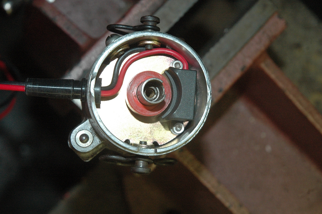

A fairly cheap distributor upgrade is to ditch the points and condenser and replace them with a Hall-effect sensor. The rest of the distributor remains standard so you still have to content with the old style mechanical advance though it is usually not a major problem.
Chris

I've just put one of those hall effect sensors in place of points and condensor. Easier starting and smoother acceleration. Well worth doing in my opinion. £33 off ebay
I agree!
I had also hot starting problems last summer with my 500F. Correct timing and adjusting the valves+carb settings sorted things out. When I fitted the whole 123 ignition it now starts very easy, just in 1-2s and a small pulling from the starter switch. 228€, worth every penny.

Having spent about 30 years making my living as a mechanic, I kind of like setting ignition points once in awhile. It is points and condenser forever for our 1972 500L. It always runs great and I love the fact that it is original!
Bruce

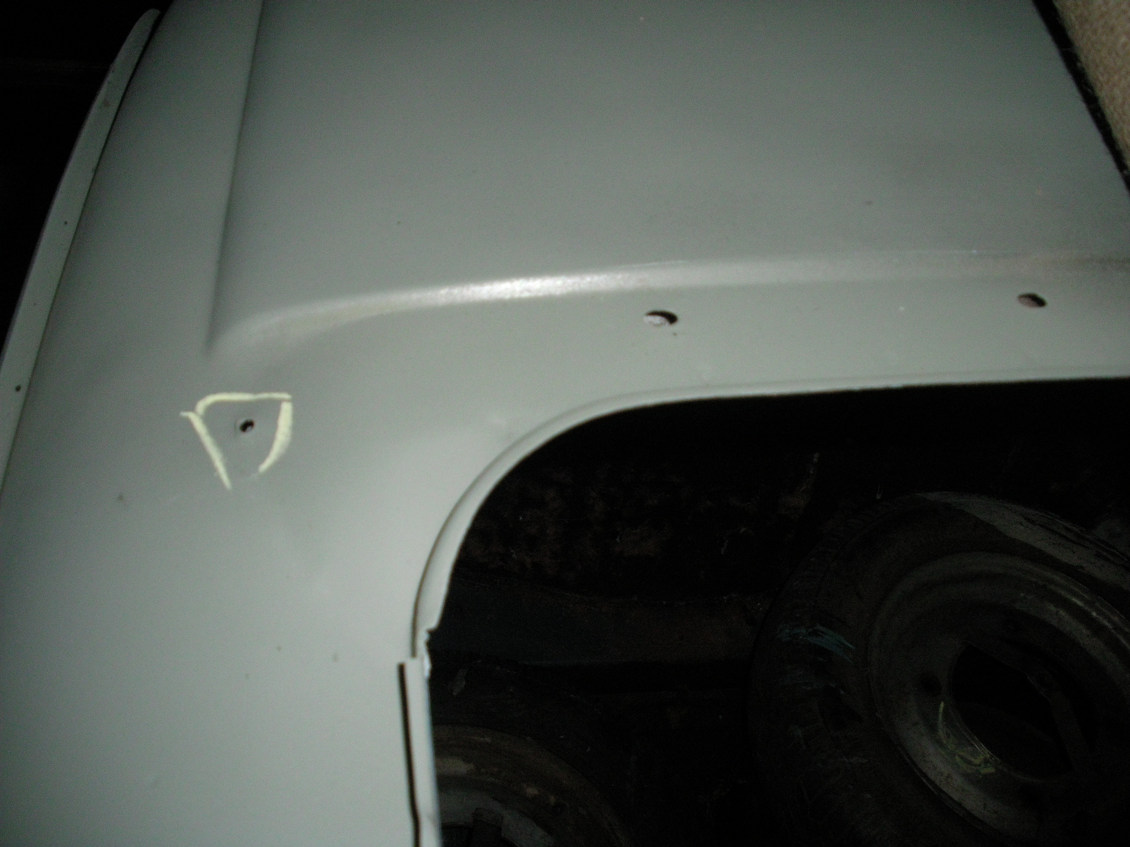

can you have a look at this for me? The hole circled is at the end of the row of holes for the rear sunroof bracket. My car had a sheet metal screw through the edge of the sunroof and into this hole (on both ends). I can't see it referenced like this in any of the diagrams I have seen but it seem a little 'rough' to me.
I need to know just in case I have to get David to seal this hole up.
Regards
Joe R
I realise this post is very old, but these holes are for the cloth sunroof ends, a regular screw goes there to bend the ends of the metal plate holding the cloth to the shape of the car. I welded mine close, (because I also didn't know what it was (but mine where huge rusted holes). Now when I installed my new sunroof kit, I immediately understood why there where hole there. However, I decided not to drill them again and just leave the metal ends as they are. It's fine so far. This, because I don't want water in the car, and those spots are so vulnerable!
the best way to secure the sun-roof bar ends is to put 'riv-nuts' into the roof (an internally threaded rivet) and then put a soft sealing washer under the end of the bar before you screw it down.

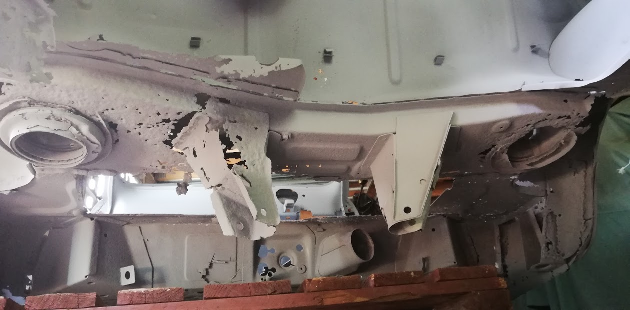

Hello all, some advice please, my 500F is back from blast cleaning. Does anyone know where to source the rear cross member with hanging brackets for the rear spring mounts. Mine look pretty shot. I've not been able to find it in the usual sources. I know is structural so will be getting a professional repair. I'm very interested to hear on what other options, experiences by others who have also had to fix this.IMG_20200516_123137.jpg
I have looked through most of the usual 500 parts supplier's body-parts lists---these parts do not appear on any of them. As far as I can ascertain, the parts number numbers that you need (original factory body book)are :--4117872 which is a rear floor-pan complete. The picture in the book doesn't show the rear wish-bone mounts, which I THINK are part numbers:--91036588 and 91036589 ( the mounts are handed). It might be that the only way to find these parts is through the 500 club of Italy, or if you have one, a friend in Italy doing some digging for you.
Hello all, some advice please, my 500F is back from blast cleaning. Does anyone know where to source the rear cross member with hanging brackets for the rear spring mounts. Mine look pretty shot. I've not been able to find it in the usual sources. I know is structural so will be getting a professional repair. I'm very interested to hear on what other options, experiences by others who have also had to fix this.View attachment 209115
Maybe start here...adapting a Fiat 126 part?
https://webshop.fiat500126.com/en/body-panels/fiat-126/others/crossbar-rear-with-coil-spring-bearer
Ref. my previous comment on this thread Peter, I think that you are correct. When you see how complicated the part is (hence its price) you realise that no matter how good a body-shop is, it would struggle to replicate the part. When the body-shop re-built the front of my car, a lot of the parts used had to adapted 126 parts.
