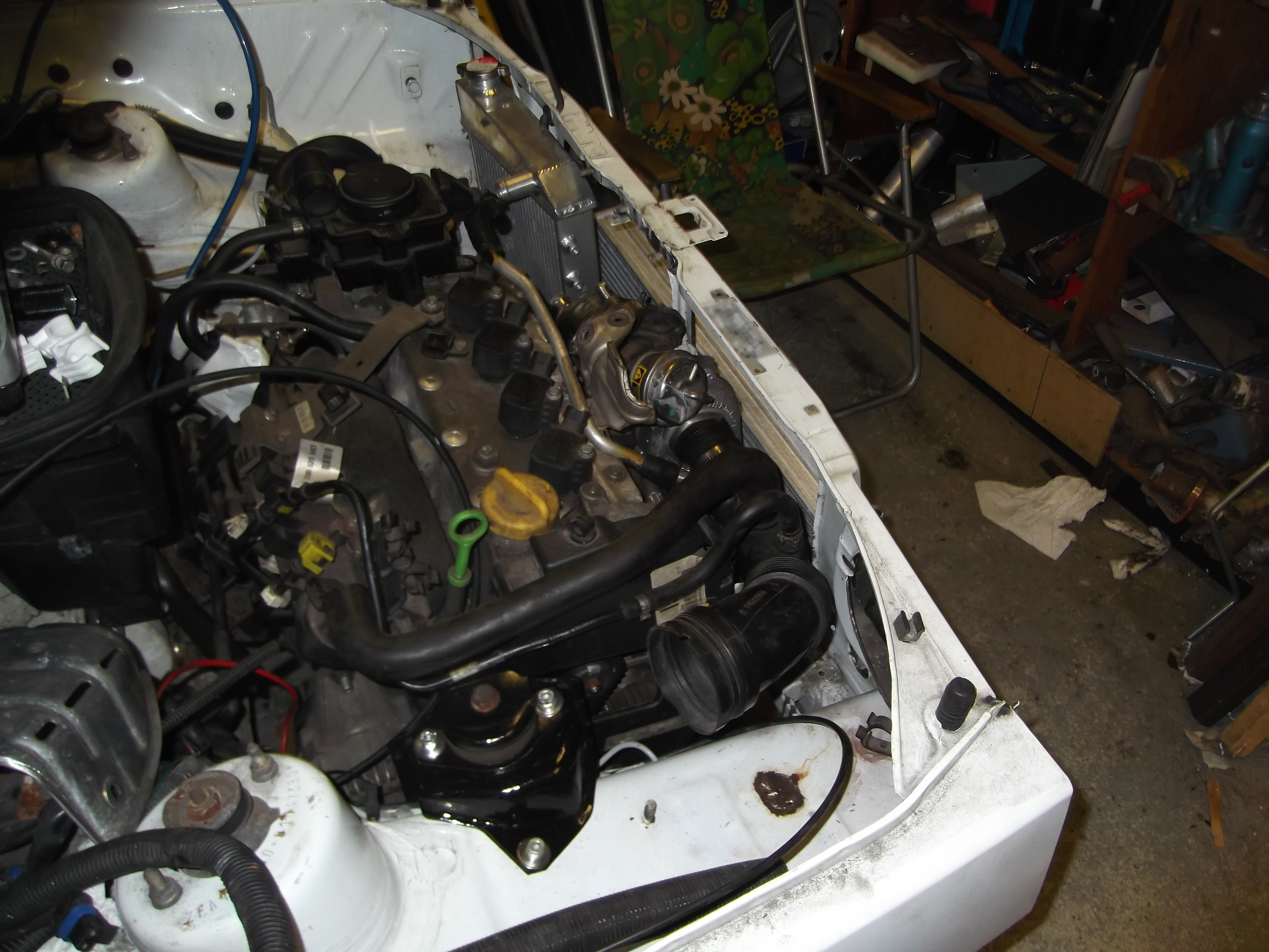

So, here's the engine! Excuse the dirtiness and again, couple of bits to tidy up, but read on for where I'm at and what I'm going to do next...

The new engine was offered up and the engine mounts put back on (all the original 1.0 ones can be used here), everything else that could be put together was put together, so linkages, driveshafts, propshaft, etc... 16v exhaust manifold fitted, new radiator fitted as mine was leaking, refitted fans and hoses, had to extend the intake manifold to meet the new port on the 16v engine. Gearbox oil (make sure you use the right stuff!) refilled, fresh Selenia oil for the engine, so on so forth...

The exhaust was a bit of a nightmare, the Punto downpipe was fitted to the Punto manifold but the bottom half of it was cut and redirected towards the driver slightly to avoid the prop/gearbox area. The centre section is the original 4x4 section, the front flange area was pretty rubbish so cut it off. Did the rear section next, as many of you know I have the yob 124 Abarth exhaust on it with two of the quad tips on it. I didn't like it as 1) it was ridiculously loud as the exhaust gas diverted away from the silencer in one of the pipes and 2) it didn't look right with offset tips! So, I lobbed the straight through pipe off and welded the end shut. I also wanted the last tip to be slightly further in away from the leaf spring when it's at its highest length so cut part of the pipe out to bring it closer to the silencer when welded back on. The straight-through pipe that was cut off was used to weld to the rest of the Punto downpipe and then clamp onto the centre section using a normal style exhaust clamp. I think that was mostly it... yeah, if I were you I'd get a full stainless, easier and probably sounds just as good
The wiring joins and the extra fuse off the positive fitted in between the battery and heater matrix so that was okay, the ECU fits in front of the expansion tank (it has plenty of, er, waterproofing of sorts...), the Sisley has a headlamp washer tank where the ECU needs to go but I like the party trick headlamp washers so wanted to keep them. For now I've taken the bottle out but it will be refitted. What I've done is I have cut the bottle as I think it's a bit large anyway, so it was cut roughly in half and a new rear section cut to size out of an antifreeze bottle and then sealed to the old bottle. I was waiting for it to dry at work so took the car home in the meantime and haven't been back yet given COVID19 at the moment so that will come at a later point. But now the headlight washer tank will fit back in its original mounting position and the ECU can fit in between it and the expansion tank. We did consider moving the whole bottle forward but 1) you'd have to remove it to do a headlight bulb and 2) you'd have to make a new mount for the bottle to sit there so cutting the bottle seemed like the easier option! A new hole was drilled in the bottle to fill it up as the back half is the usual filler... not any more!

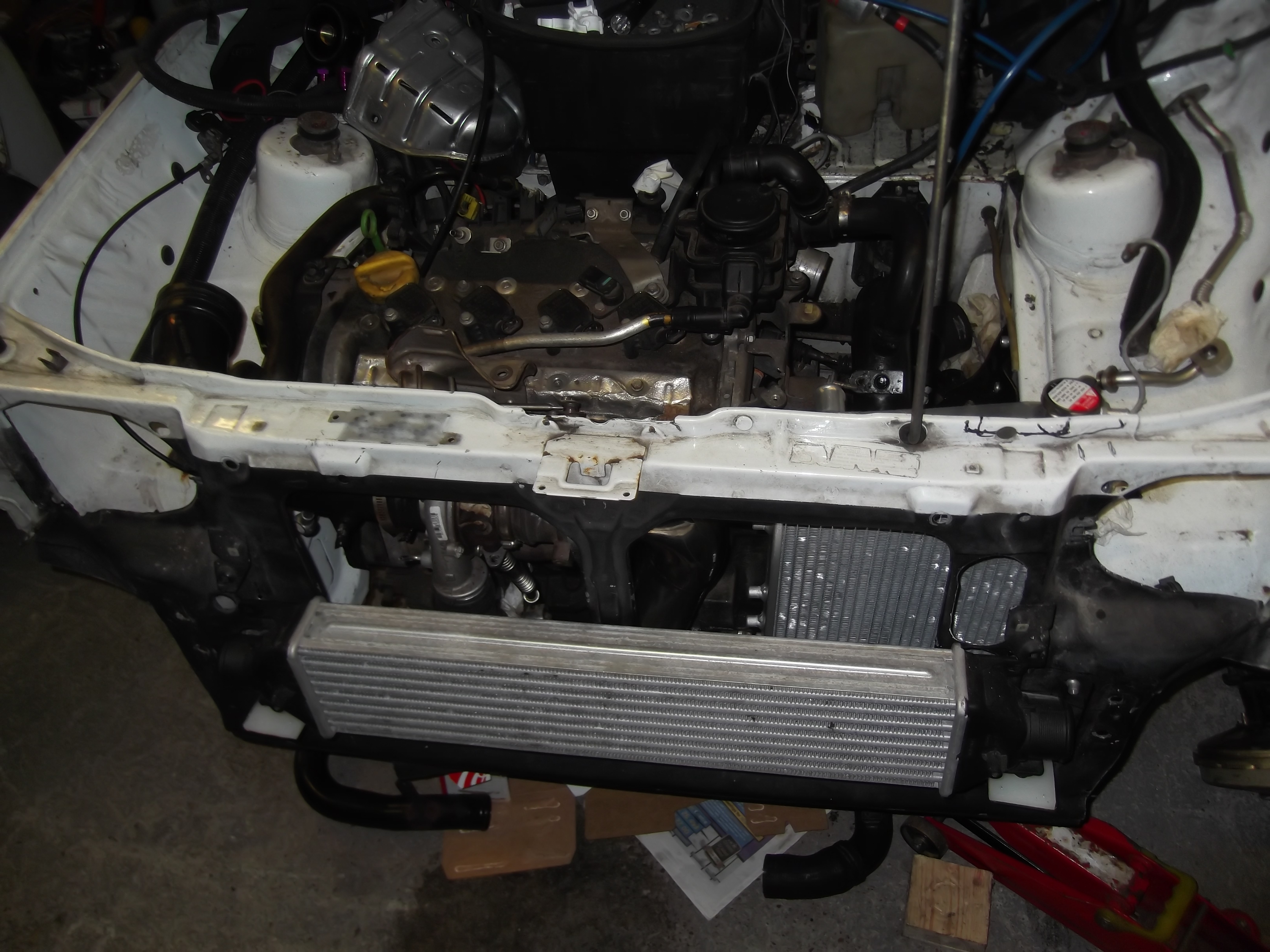

Another thing I sort of forgot is you have to cut the matrix box at the front for the 16v inlet manifold to fit. I cut out a whole rectangle off the front so it looks "ish" neat and left the right hand side mount on for the flap. I drilled a hole in the left side of the flap so I could cable tie it in. It works as it should!

Put some of the insulation back on to cover the wiring mess that lies behind it...
Yep, I told you it was a mess, it works though

While looking at this picture I remember we had a couple of water issues to start with, the fan switch on the new rad I fitted wasn't tight (it came off another working car) so tightened that up as it was leaking, and I cut the end off the pipe on the return end to the expansion tank as that was leaking too and fitted a new jubilee clip to it...
