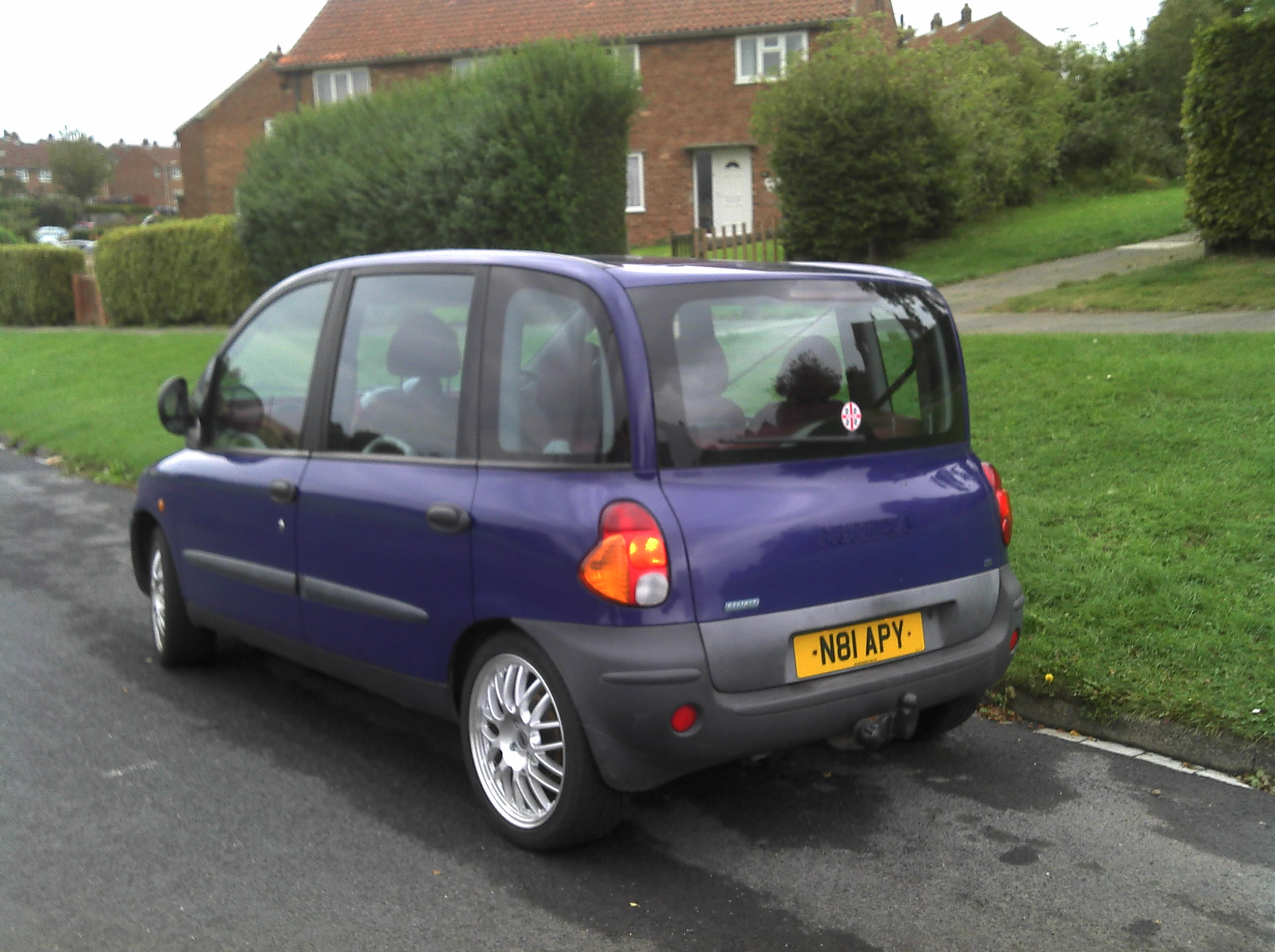

this is my multipla with the new 17" on(y)
looks pretty good and was easy to do!!:D
now i need the abarth bodykit on so i can get rid of those black bumpers!!:yuck:
the problem is that is very hard to find...:bang:

You can buy GRP copies of the 'Abarth' (did Fiat actually sell it as this?) front bumper from a couple of places, such as:
http://www.madmotors.co.uk/bodykits...pla/mm-fiat-multipla-abarth-front-bumper.html
There was another company doing them for less than that but I can't find them ATM. Not many places do the rear bumper, but to me it (i.e. the rear one) looks pretty naff compared to the OEM anyway. The 'square nose' Multipla rear bumper is nice, but I don't think it will fit the earlier models.
By the looks of things your wing mirror stubs could do with a bit of love. I took mine off, rubbed them back to bare metal (got rid of ALL of the white oxidisation or the paint wouldn't key properly) then primed them with:
http://www.screwfix.com/p/plasti-kote-metal-primer-400ml-grey/25368
and top coated with:
http://www.screwfix.com/p/plasti-kote-metal-protekt-metal-protection-paint-matt-400ml-black/22150
Nearly a year on and it's still looking good. No sign of any paint lifting yet. The appearance is very close to the factory stuff.
Yes thank you.
I did see that bumper for sale but they dont do the rest of the kit! (Side skirts and rear bumper)
I have an original fiat brochure and there is a picture of a multi with a full kit and it looks very nice...if i just put the front bumper it wont look good. Ill just have to keep searching and see if i get lucky...yes i need to sort those mirrors and i thank you for the advice, but as you can see from other thread i have to sort rear suspension arms as priority...
