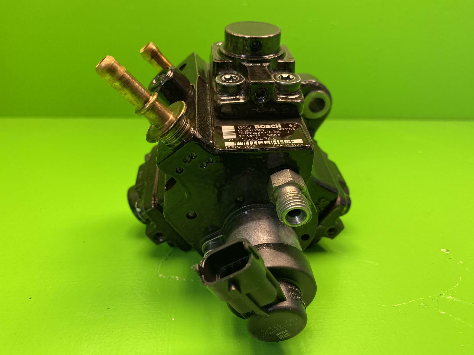

by several different suppliers (including one with a high street presence!) that the "0928400 680" is a direct swap for the 0928400 825 which is now sitting on my desk. - Dimensionally they're certainly the same, the green ring may or may not be a moot point. Both have DC coil resistances of 2.6Ω/2.7Ω... The only difference being one is 'normally closed' (the original) and the other seems to be 'normally open'.
The outer bores are (I'm led to believe) the inlet side the middle one the outlet... I am fairly convinced that the one I've removed
is original to the car, and it
did emerge from where it had been nestled
sans ring. - This makes me question whether the ring is something that is required for some variants and not others; however - there is no fuel escaping.
Out of sheer curiosity I took the ring off and refitted it; this time
I was seeing pressure but still no sign of a start... but then after a couple of tries sometimes no pressure. So, whatever this thing
is doing, it ain't doing it right!
Not only might I have been mislead over the part numbers; but I do believe this thing to be a piece of chinesium garbage. Tomorrow, when I'm feeling less demoralised, I'll re-fit the old one and see if I can get the car to start and get myself back to square one... at which point I'll order up a genuine Bosch 0928400 825 from a supplier I can actually trace to a UK address!
One thing I've definitely learned from all this is that regardless of company size - the people staffing modern-day parts suppliers aren't like the old-school motor factors and probably aren't even that good at interpreting whatever databases they're looking at; assuming that is they're not just Googling stuff like everyone else!
As I said - I wouldn't normally expect the rest position of a valve to make a difference in a PWM system; but then this is a car engine, not a camera crane - and it's entirely possible
the ECU is expecting the thing to be closed when it's open and open when it's closed. - The same pump is fitted to various engines in various guises; and I suppose just because the thing physically fits (and perhaps some ECUs don't care and work fine) doesn't mean it's going to work in every configuration.
