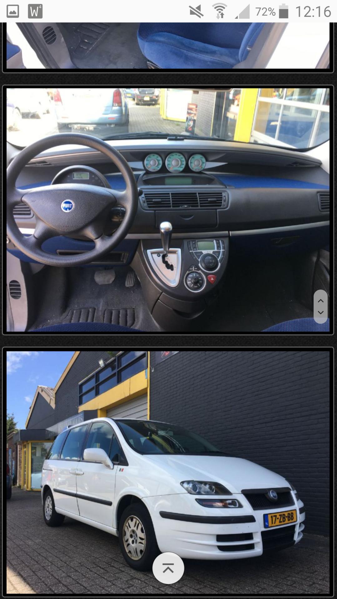

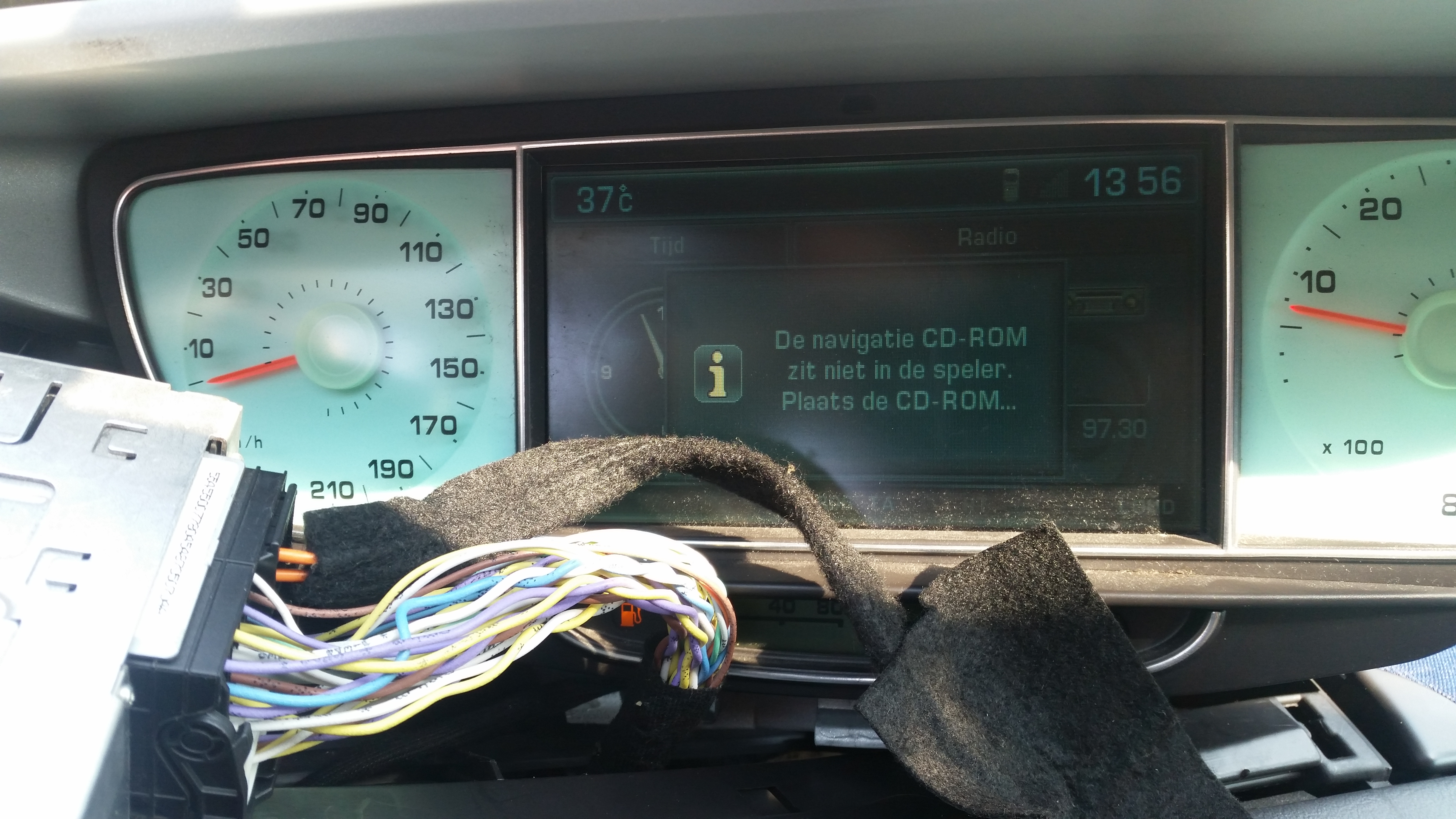

I change the little monochrome display en round cloks for the LCD full color display infotainement. See here the simply steps;
1. Pul out the round clocks, display and the RT3 N1 radio
2. Replace the RT3 N3 radio (glassviberports) glass viber cabel and the LCD color
3. Synchronische this with the VIN (lexia)
Hello! Tell me please how can you use lexia to this Ulysse. I have a '04 Ulysse 2.2 JTD too, but with original vin (ZFA...) and without DAM code i can't connenct lexia to this car. ThankYou!
