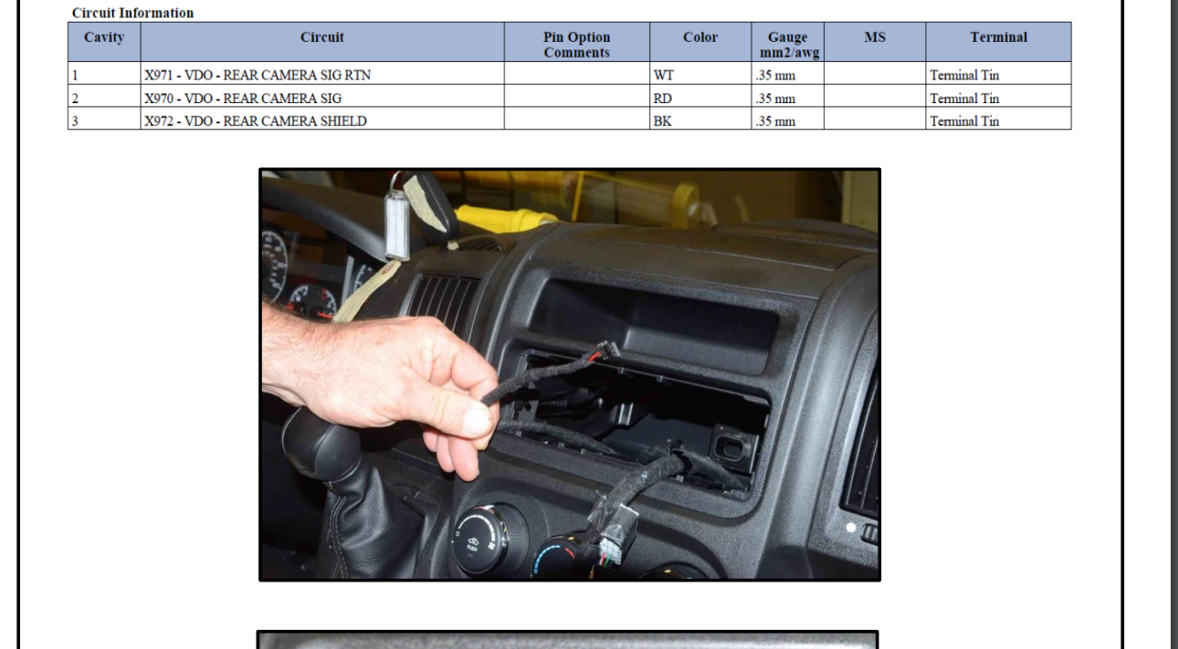

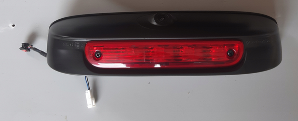

Hi All, My camper (Forster FV 599 HB, 2021, LHD) is fitted with a factory reversing camera, but was delivered to builder with no headunit, etc, and was installed with an after market Alpine headunit. The factory reversing camera appears to not have been wired (the RCA from the headunit is not...
