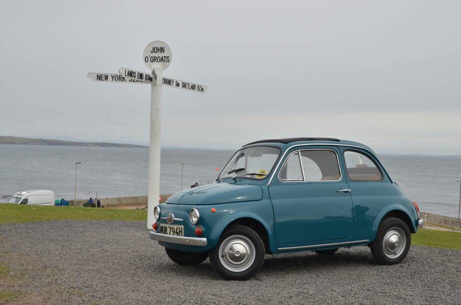

The repairs successfully blended in to the car.
