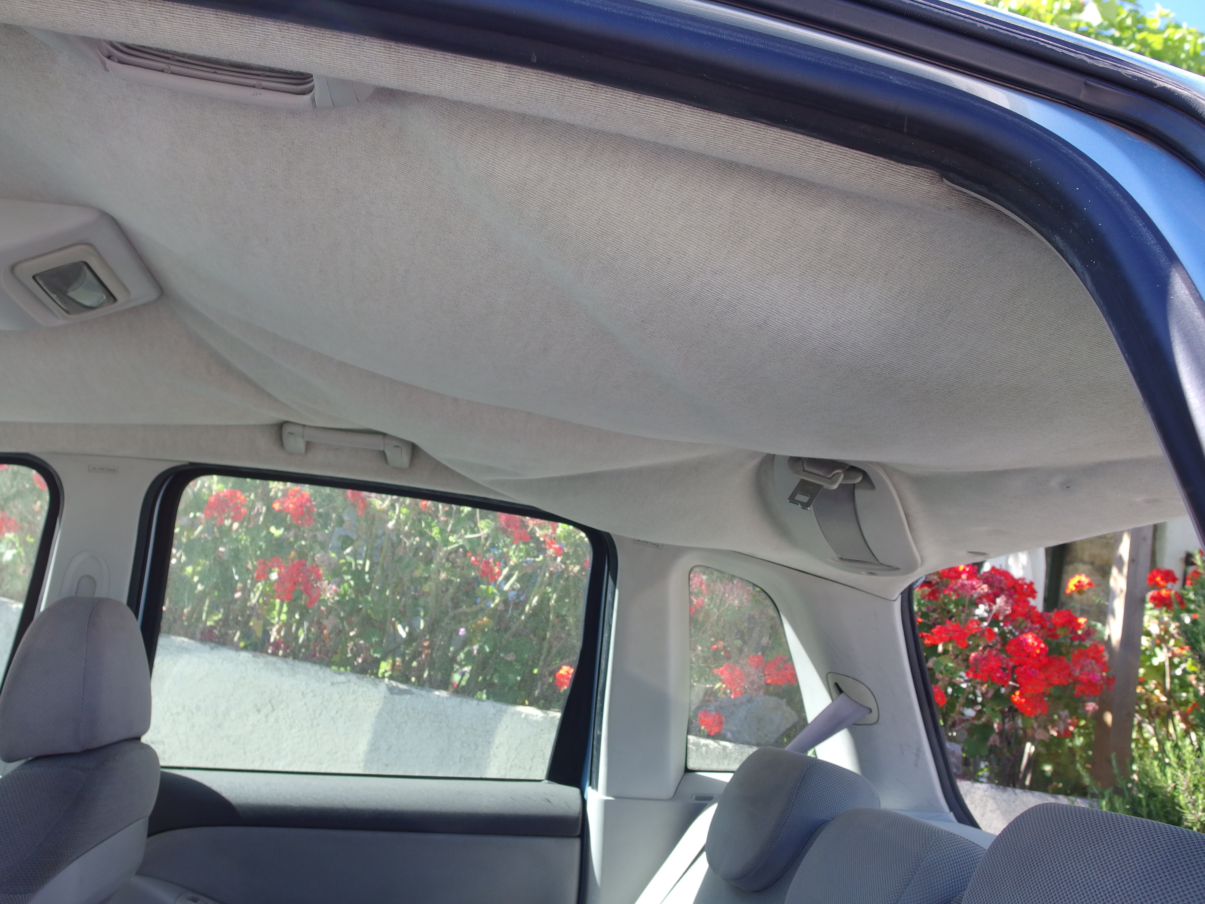

The headlining on the fiat idea has gone all droopy ... I think it's something to do with the hot weather we have been having here melting the glue ?..It seems in good nick for a 2004 car but it's drooping down ... any one had this problem ? is it possible to glue it back up ? any glue clues ...

Hi
Had this in my Vauxhall Corsa 05 plate and used spray adhesive
I did have to remove the whole thing from the car peeled it back half way glued that down and then did the other half
Its not a five minuet job, but if done properly will look great and last for years
