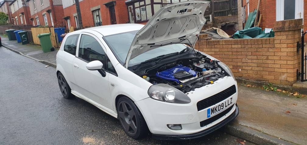

Getting 'p0240 boost pressure sensor B circuit' fault code, cars very down on power and only making 3psi of boost. Checked all the vac lines on the boost solenoid and they all seem good and the right way round, any other ideas? Tia.
Read up online that the recirc can be faulty and leak air/open to early before hitting peak boost so I blocked off the recirc then took it for a test drive and was back up at 1bar of boost running perfectly fine, it's not long had a new recirc either but I'm guessing the ****ty plastic valves are only good for standard so will be updating with a forge one.
